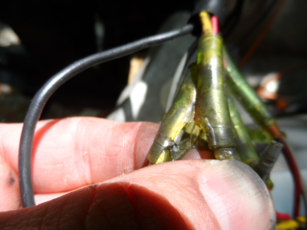

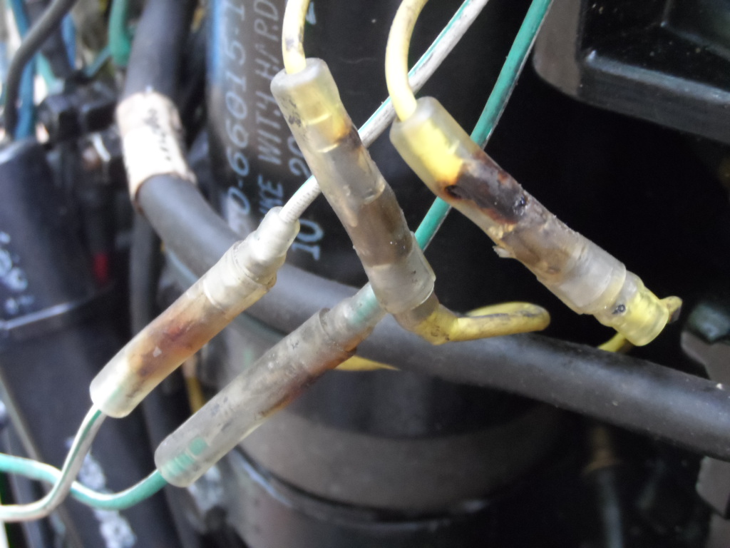

I put this in my rebuild thread too, but the end of last summer the toon would just die no sputter nothing just pffft. AFter 5 minutes or so start back up...It would do it one day and not the next. On Labor day weekend it did it twice at the end of the day. Didn't go out again and when I winterized it, she started for about 30 seconds and died. Now it doesn't start at all, no spark in any cylinder. I found all four of my wires coming from the stator look burnt.
I am assuming it is the stator... I just ordered on of ebay for 125 so it could get here by Thursday :prayer :scared

curtiscapk wrote:I put this in my rebuild thread too, but the end of last summer the toon would just die no sputter nothing just pffft. AFter 5 minutes or so start back up...It would do it one day and not the next. On Labor day weekend it did it twice at the end of the day. Didn't go out again and when I winterized it, she started for about 30 seconds and died. Now it doesn't start at all, no spark in any cylinder. I found all four of my wires coming from the stator look burnt.
what do you guys think? and how the hell do you get the crank nut off!? :x
That doesn't make sense to me. The stator is part of the alternator. If the alternator was not putting out, the battery would still run the sparkplugs. If the alternator was out, your battery would eventually die. Is it? I see four wires. Does your engine happen to have four plugs? Does it have a "coil on plug" setup?

Did you try replacing the burnt connectors ? I'm more familiar with Evinrude/Johnson of that year but the flywheel nut is a bear to remove. I used an impact gun and flywheel holder.
Burnt connectors usually means water got in and corroded them. Replace them with heat shrink connectors...

I didn't replace connectors pretty sure it is the stator ...what I didn't show was one of the wires had rubbed through on the block you could barely see bare wire. I would assume when it died the couple times before it was making contact and shorting out? Then it just got smoked. The 94 stators I have read had a habit of going out on their own. I do need a puller but from what I have read harmonic balancer pullers can usually do the job and I can "borrow" one from Advanced auto. Instead of paying 50 bucks for the merc puller that I will use once. There is a way to check wether stator is bad, but didn't have my volt meter down there so I am running blind... If it isn't the stator you may not hear from me again as I will have been forced to walk the plank from the admiral....

Yeah, grounding out will fry it quick. That also explains the fried connectors. :scared

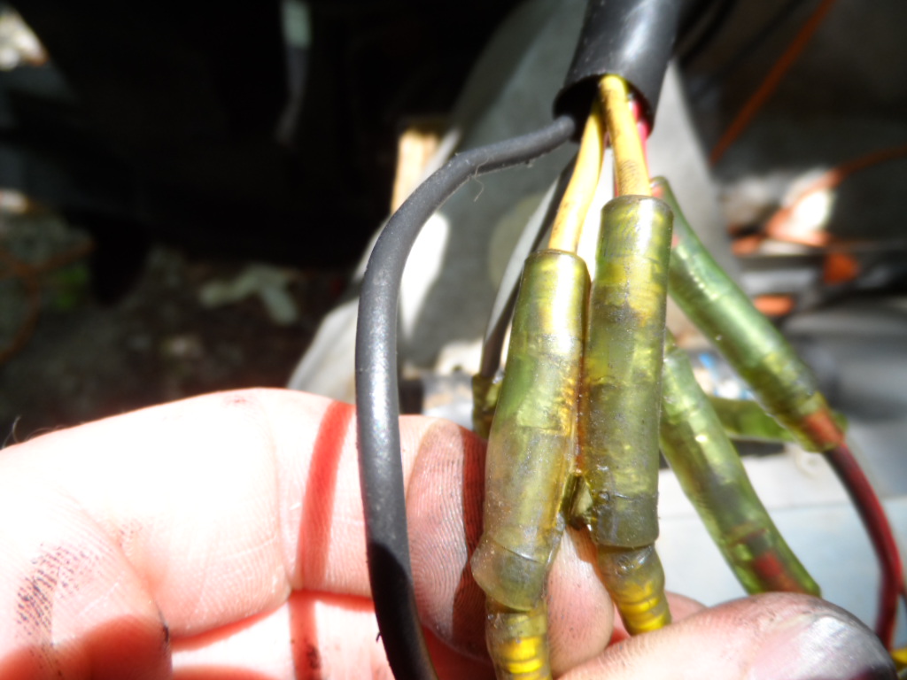

I started unhooking the REgulator and noticed two of its wires were melted together... Damn these barrell connectors suck!
