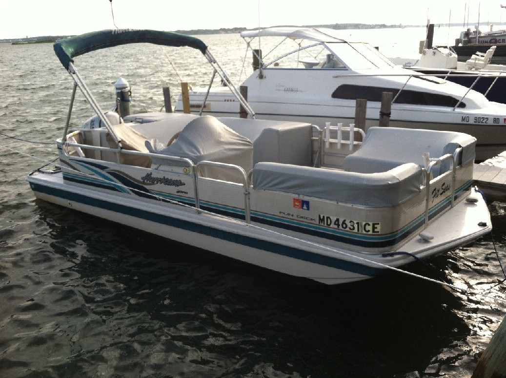

And not that it has anything to do with the subject, but here is a pic of my boat.
- Copy of photo.JPG (221.58 KiB) Viewed 3770 times
