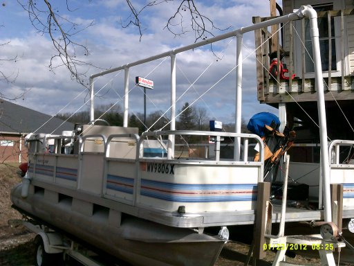

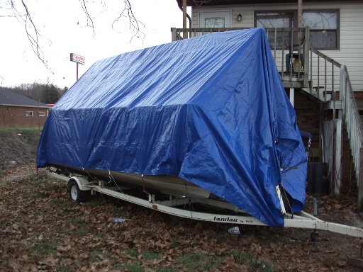

Over the last 2 winters this is what I have done with very good results I made a frame of 2 inch PVC pipe and use a new tarp ever year. Its made high enough so I can slip inside and work or just sit and get away for a bit, But I also dont have extreme weather.
Re: To shrinkwrap or not to Shrinkwrap..? That is the question.
- frame.JPG (63.53 KiB) Viewed 2572 times
- inside 5.JPG (135.71 KiB) Viewed 2573 times

Pretty cool MH! Looks like you can actually walk around in there.
My biggest concern is snow & ice (been getting a lot of ice storms lately) which ends up being very heavy. Even pulls down on the shrink wrap sometimes. I like the PVC idea instead of using wood.

I agree! Thats a good idea!
I can in fact. The pipes are 6 feet tall. I get a new tarp and straps ever year for 40.00 from HF, if I remember right the tarp and pipes and bungee cords ran about 65.00 the first year I installed my new console in it last year under the tarp it was a bit of a pain, but I wasn't in a hurry, I keep a propane heater in there so when I feel like doing some work I can heat it up nice and toasty, but it would really depend on your climate I mostly get a ton of rain and that's why I went to that so I can keep a eye on it and keep it dry to keep the mold away and the last 2 years not the first bit has showed up. Lol and its nice to grab a beer just go out and sit there awhile when the wife and her daughter get to bitching at each other.

MH... that's a nice set up... very impressed!!!!!

This is an awesome idea!!!!
