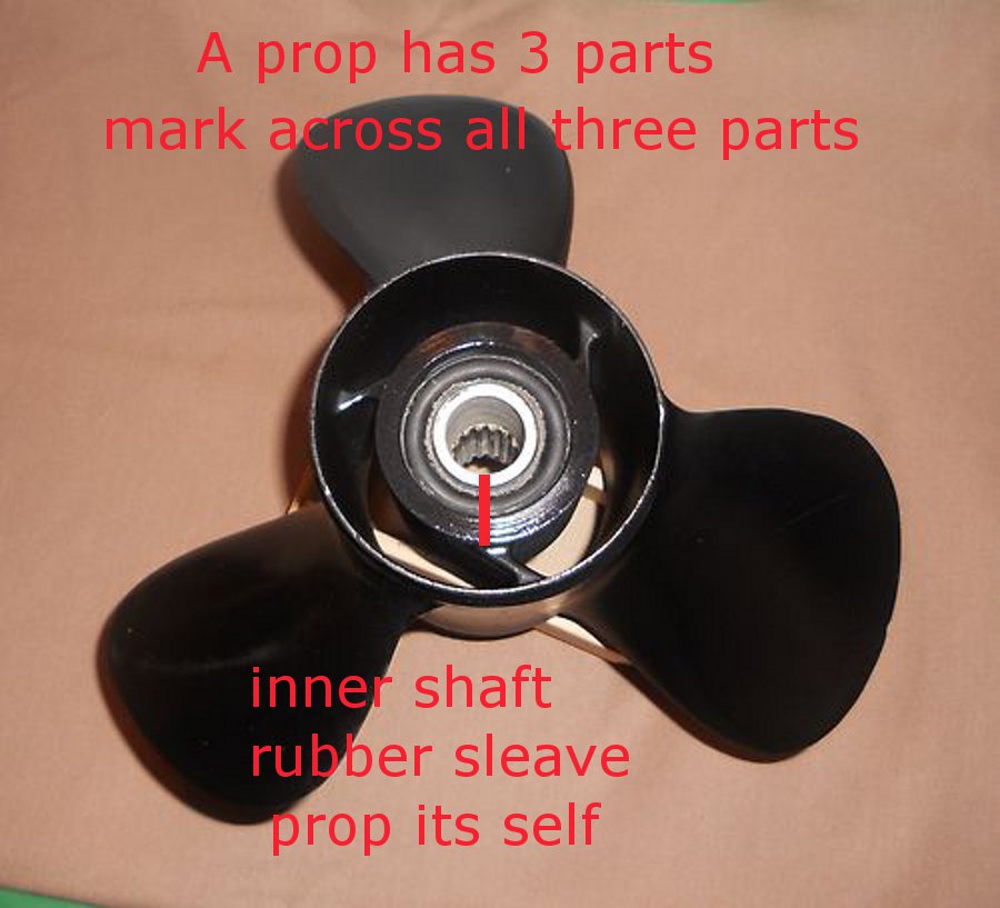

You can take a permanent marker and mark the prop and hub. Run it and check to see if the marks are still aligned to see if it slips.

#7 Post by MH Hawker » Sun Aug 25, 2013 8:55 am
Make a mark across it some thing like this and go for a ride and pull it back out and inspect the marks, if the marks dont ling up the way you made them then you know its slipping.
how to mark a prop hub 1.JPG (82.9 KiB) Viewed 3136 times

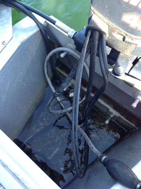

I took my prop off at my marina and brought it in for them to replace it. Figured I'm gonna pay twice as much for one from them but heck...I need to be on the water by 2pm :drink4 ....My marina guy takes it and checks it out and says the prop is fine... :?. He says there must be something hanging by the motor...I said "What..What could be hanging??...He says maybe a fuel line or battery lines....
Sure as sh*t we walk over to the boat (which is in shallow water now) and low and behold the section of fuel line that lays in the transom is hanging though the outlet on the bottom. He says... yep that's the problem. We put the prop back on, pulled the fuel line back in and she runs like a champ... :nana. I nver realized the line was even hanging in the water and I never wouls have guessed that the line would have created such an issue. Anyway the day was saved.
fuel line.jpg (147.75 KiB) Viewed 3081 times

#10 Post by MH Hawker » Sun Aug 25, 2013 9:32 pm
You need to replace that gray fuel line. It has a inner liner that breaks lose and wads up inside.

MH Hawker wrote:You need to replace that gray fuel line. It has a inner liner that breaks lose and wads up inside.
Replace it with another? Or a completely different type of hose?
