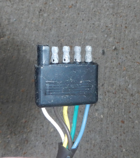

Hardest part was feeding the power line through the loom without messing it up, and then soldering to the blue wire (backup lights)
5 wire connector.jpg (95.78 KiB) Viewed 1968 times

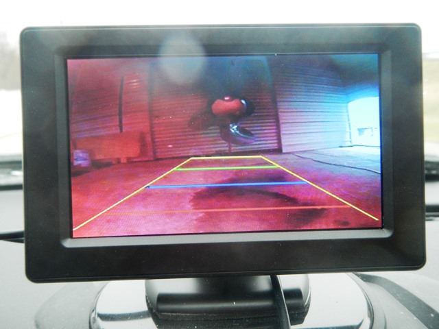

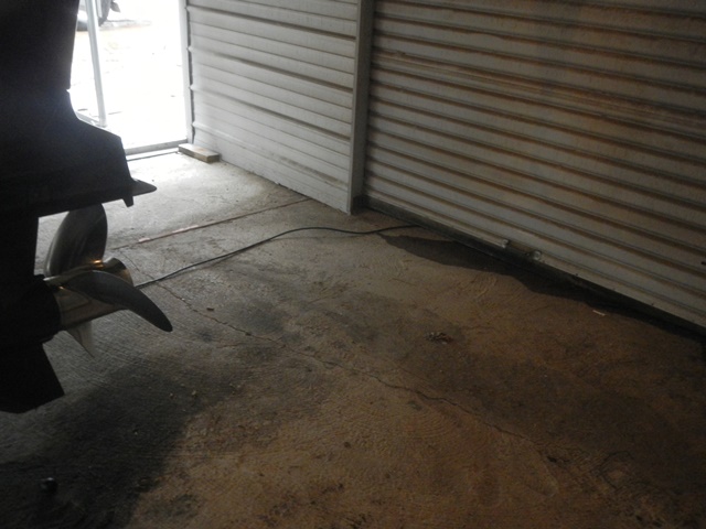

This is how far I am from the back, you can compare it to the grid on the display
The grid is pretty helpful, you can see my prop in the display. the redness is from the brake lights.
Display with grid.jpg (82.51 KiB) Viewed 1967 times

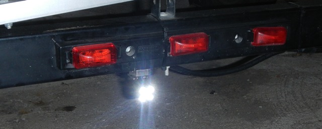

When you put it in reverse, the lights come on and the camera starts sending video
camera with lights on.jpg (61 KiB) Viewed 1969 times

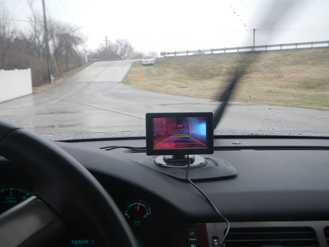

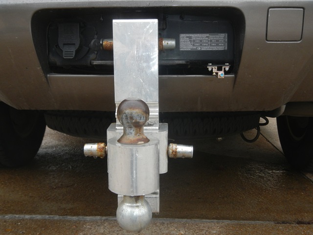

the display sits on the dash and plugs into the cigarette lighter, and the long coax from the back of the 'Burban. I can remove it so Heathens don't get curious.
Display on dash.jpg (82.5 KiB) Viewed 1970 times

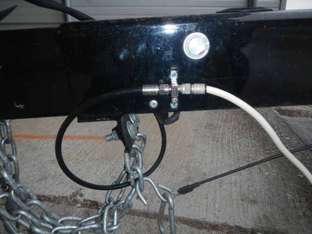

On the trailer side, I put a connector so that I could replace the only moving wire if/when I need it
Trailer side.jpg (111.86 KiB) Viewed 1967 times
I put these caps on to keep the funk out
Truck side with Cap.jpg (102.7 KiB) Viewed 1967 times
Here's where I' mounted it
Truck side position.jpg (95.98 KiB) Viewed 1965 times
