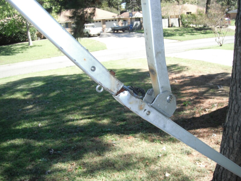

Be careful with bending it back. I'm no scientist but I have to suspect that once it's bent it's structurally compromised forever and bending it back would only make it worse and you'll end up with something like this:

If its bent on a straight section (as in the picture above), any competent fab shop should be able to sleeve and weld in a replacement chunk to get it to 'as-good-as-new' condition. Find out where you local auto racers go. They should be able to help.
Tim

Thank you very much for the replay. I've taken it to a fab shop who is doing just what was suggested. Cutting out bad, sectioning in new and inserting a doubler on the inside of the tube.
