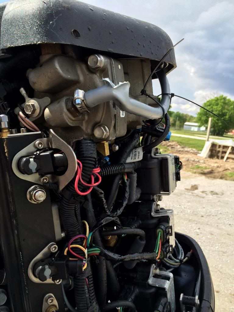

Memorial day was great....first few pics. But if it makes you feel any better, the week before wasn't. Had a high pressure line on my optimax blow. It was not the factory high pressure line.
Week before I had to get towed in.
blown line
tow in
Ferg's Tritoon Build

wow fergusmj-------what yr is the motor? That's a new one on me.....beautiful boat btw.....Is that a fuel line?
