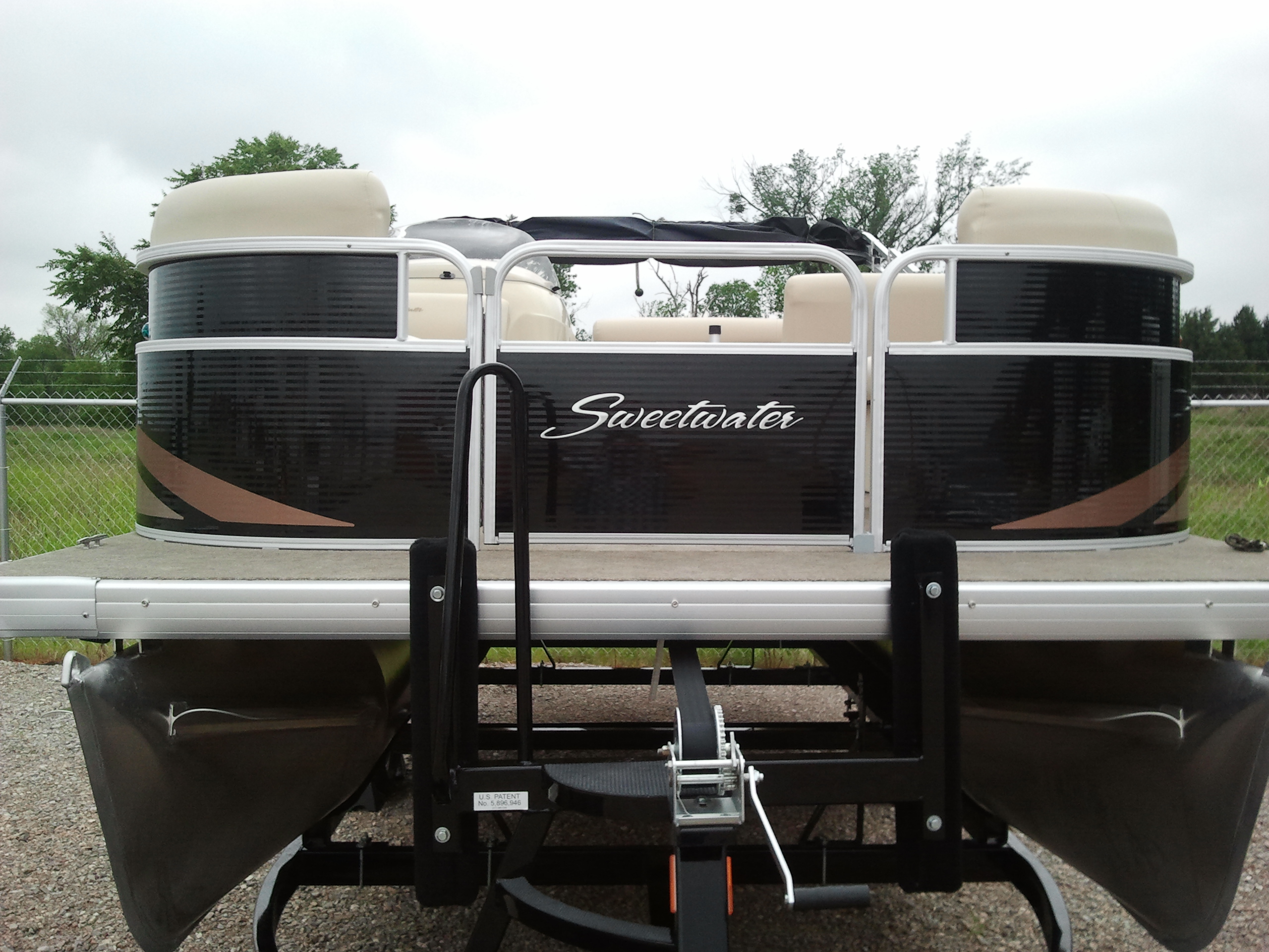

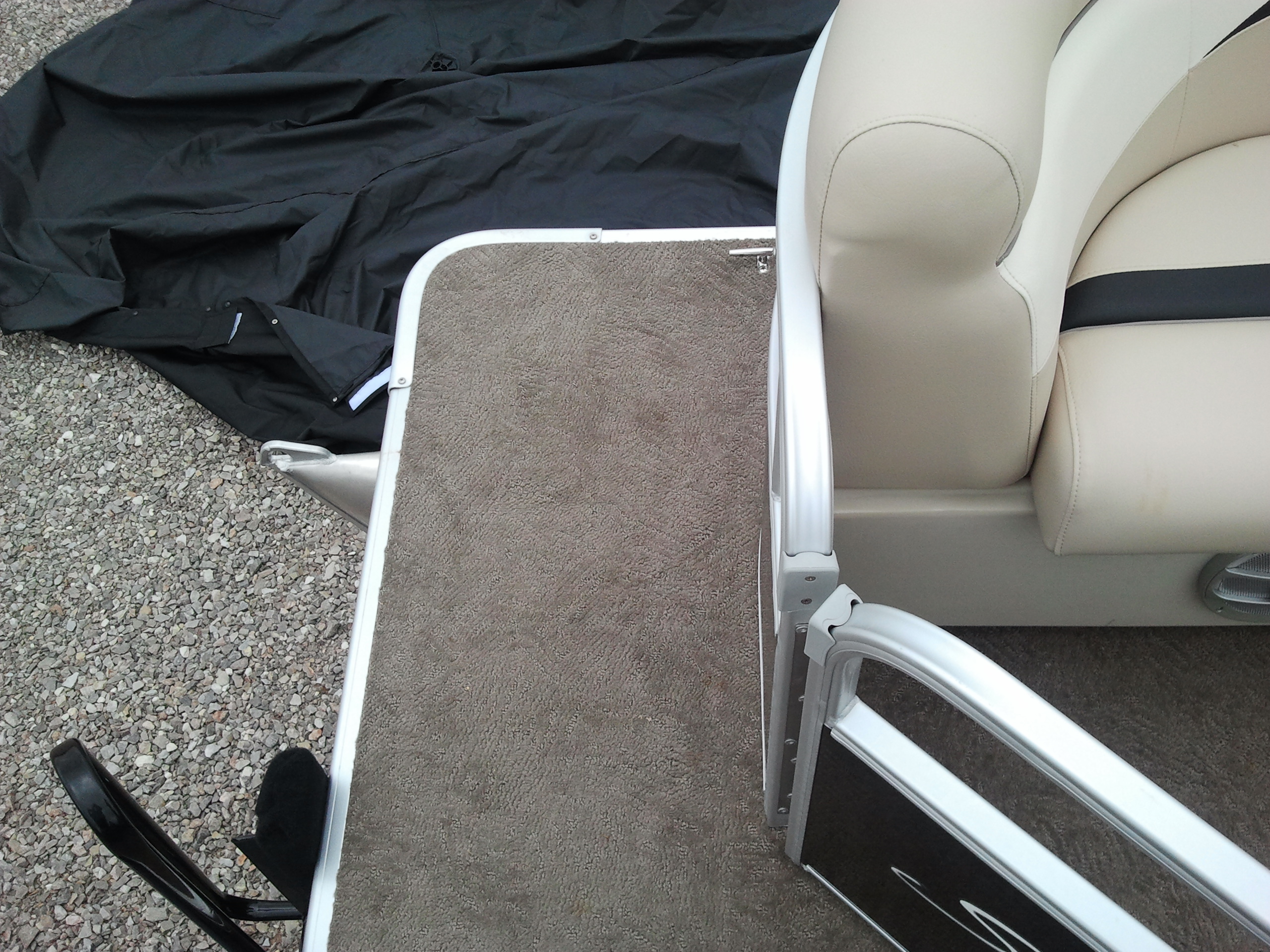

Here are some pictures of the front of my ride. There is plenty of room to put something up there. Do you guys think a manual trolling motor would be best since they just stand straight up and down?
