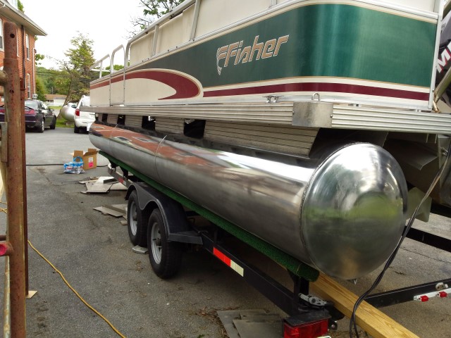

I went to work with the http://gordsaluminumpolish.com/ polish and buffer today.
Sharkhide is on it's way.
- IMG_20140517_183226.jpg (100.5 KiB) Viewed 5683 times

I watched the video, this product looks to be a lot easier than some, what do you think about using this to polish and then cleaning and sealing with sharkhide?

rockhound wrote:I watched the video, this product looks to be a lot easier than some, what do you think about using this to polish and then cleaning and sealing with sharkhide?
This is what I am going to do, I just have to apply Sharkhide now. I just haven't had the time yet. I will polish it one more time quickly, then sharkhide. I'll let you know how it is. I am in the water, on a mooring all summer, so the sharkhide will be thoroughly tested.

Did you preclan the tubes or just go with the polish

If you're wanting to follow with Sharkhide, you're work just started. I found getting polished aluminum clean (of black oxide) to be much harder work than the actual polishing. It takes some serious elbow grease, towels and lacquer cleaner to get aluminum clean.

rockhound wrote:Did you preclan the tubes or just go with the polish
I used the napa Aluminum Brightener Cleaner. http://www.napaonline.com/Catalog/Catal ... 0410678680
It cleaned the pontoons and then I used Gords to polish them
