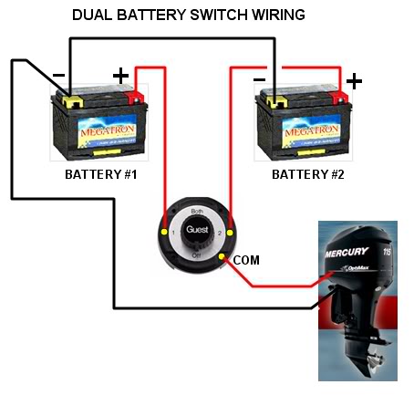

If I knew who to credit for this picture, I would. I may have just found it on the internet, but I don't remember. Good luck to you. (We have a second battery and glad we do.)

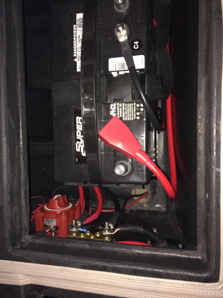

It's fairly simple to add the 2nd battery (as shown in the picture). You can also add a Voltage Sensitive Relay to ensure you'll always have starting power. This may not be a big deal if you don't run much of anything on your boat. I went ahead and did it just to be safe.
here's the VSR / Switch setup I purchased.
http://www.ezacdc.com/boat-wiring-produ ... h-systems/
Pics of install.

stickman wrote:If I knew who to credit for this picture, I would. I may have just found it on the internet, but I don't remember. Good luck to you. (We have a second battery and glad we do.)
Looks like one of Silvertip's pictures from iBoats.
