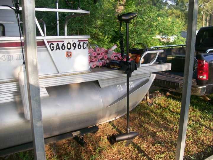

#5 Post by cuda67bnl » Tue Jun 17, 2014 5:44 am
Here's a shot of my 54" so you can see just how long it really is. In this pic, it's even with the bottom of the log. I usually run it a little deeper than this, but never all the way down.
