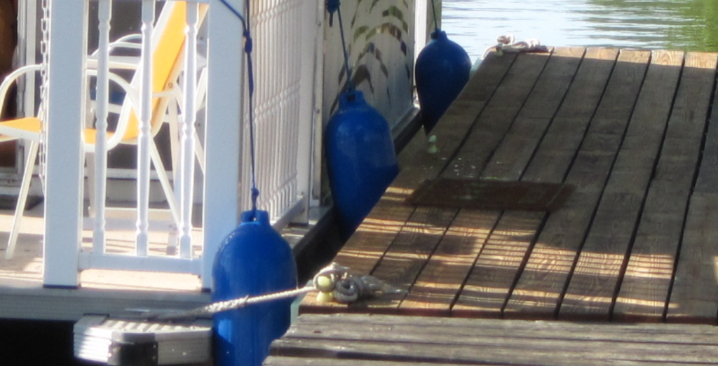

On our water, a river I've never observed anyone tie off other than the way shown in the picture below.
Pontoon Tied Off.png (1.16 MiB) Viewed 2052 times
You now have to also realize that the line isn't actually as snug as it actually appears in the photo. When this photo was taken a breeze was actually pushing the boat upriver as far as the line would allow. A person doesn't actually want their boat tight-lined to anything for some very good reasons. But first off.... For your home dock lines get a good set of lines and set them up for your boat a forget them for the season. Yep set them and tie them off proper to the dock posts utilizing the loop on your cleats and leave them. It will make life so easy after a busy full day on the water.
But one of the big reasons a boat needs some rope to breath is wind, wakes, storms, and blows. It's amazing just how much up and down movement can be created in any of these events. I've sat in my boat on the dock at one time or another and observed all of them. When the boat starts heaving side to side and our floating dock decides to oppose the boats movement it well makes for an interesting observation to say the least. But one thing you would become aware of we are talking about some significant forces at work with enough energy to destroy any weak link in the works and cause damage. But anyway set your lines appropriately and enjoy your time on the water. :thumbsup
