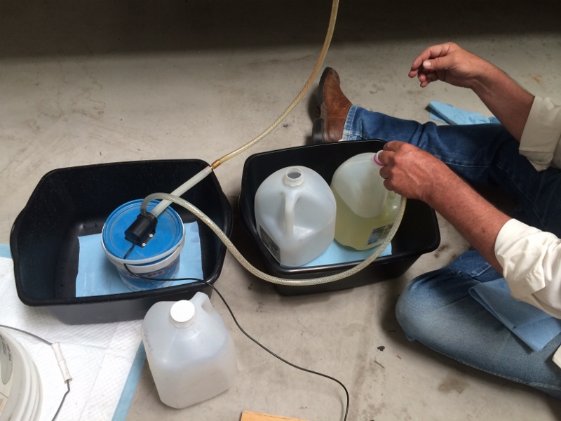

We drained about 9 gallons of fuel with a little pump and filtered out the water

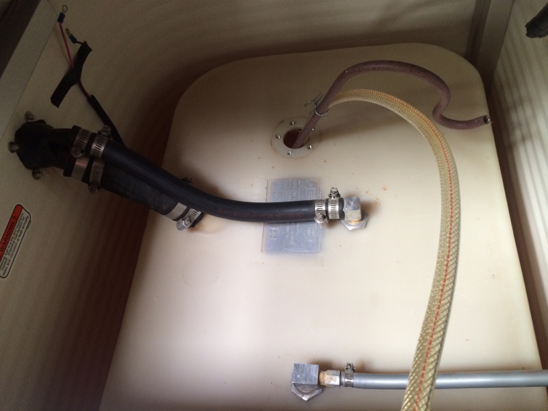

This shows the hose in the tank

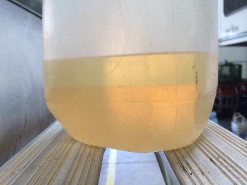

This is what we got.

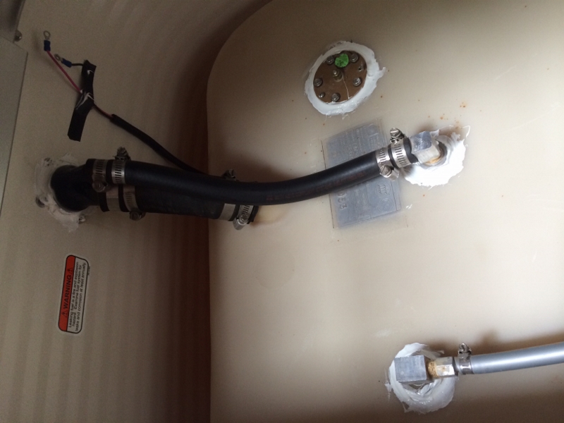

So we caulked everything and we will test with water tomorrow to see if any water ends up in the tank. We will also tape a big sponge on the top of the tank. I'm hoping this is what was wrong. Anyone ever have this problem?

You know, I just don't know. Maybe you can check your tank and see if it has rubber gaskets on the outside and inside of the fill. Ours doesn't. The hole wasn't cut very pretty and I'm thinking that's where the water was coming from. Hopefully it's fixed now since we caulked it inside and out. It's possible that the water pooled since we had it on a slip for 2 years but we have an enclosure to keep the back dry and I always tarp above the tank and it's really high off the water. Also the aluminum siding is corrugated, not smooth so its not flush. That might be the culprit.....lakerunner wrote:Is it possible water is getting under cover when underway and pooling on tank?

There should be a rubber gasket under the fuel cap also. Make sure it has not fallen out.

Were missing that too. I think we might have this problem fixed. ThanksJonvee wrote:There should be a rubber gasket under the fuel cap also. Make sure it has not fallen out.
