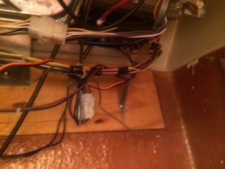

Thanks for the input, I have figured out a few more things which will either help things or complicate them. At first when started the tach would show 4000rpm while idling, usually around 1500. I replaced the fuse on the accessory (+) cable even though it was good just corroded, and connected the accessory cable also. All the lights worked, radio worked, but no horn, and...it wouldn't start, no trim either. Disconnected the accessory cable and it started and trim. So that must mean something is shorting that out? The dealer out here said muskrats have been chewing up wires, so I looked underneath and sure enough, part of a wire is eaten to expose a small piece of wire, which was under water. I can't follow the front of the wire, but the back end goes down to the lower unit, it's about the diameter of a pencil. (What is that?). So then when looking at the wiring behind the dash, I did see a brown wire hanging with an exposed end. I can't tell where it went, it's under the radio and behind the speedometer and ignition. I'll try to post a pic to see if you happen to know. So I did find a few things out, the only problem is these things were happening even before I hooked up the accessory cable, so I don't know if it's related or another problem. Put a meter on battery 12.7 off, like 13.4 running, and tach is showing 1500rpm
small wire.jpg (35.31 KiB) Viewed 1699 times
