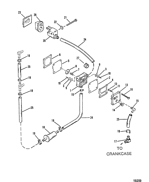

Engine is a 2005 Mercury,90hp, 3cylinder.The fuel line that runs inside the motor has split and I can not seem to find a part number or what it is called on line. The line has a outlet in it that is plugged off, then it branches off in a Y. Looks like one goes to high side and one low? I have it so it will work now, but want to replace it with the correct line. Thank you for your help !

This is a very good site for diagrams/parts for Mercury/Mercruiser. To better find the right part, you need your serial number:
http://www.mercruiserparts.com/Show_Pic ... =Fuel+Pump
What I do is use this site to get the part number, then search for it online (eBay, etc.) to find the best price.

- 19259.png (19.32 KiB) Viewed 1167 times
