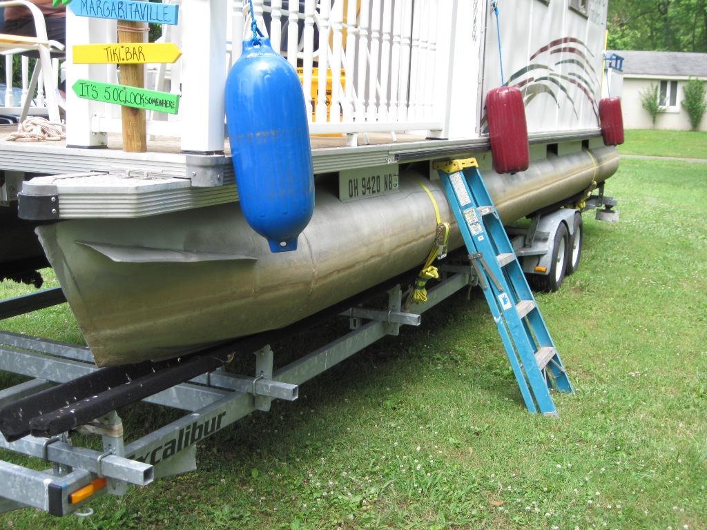

#8 Post by Bamby » Fri Jul 18, 2014 6:40 am
Well maybe we've not yet seen everything?
pontoon boat trailer , billboard 001.JPG (307.63 KiB) Viewed 2268 times
Boat is 35' in length, the trailer weighs 4,600 lbs. empty, the wheels are 15" with 6 bolt rims. The trailer handles the boat OK but as you can see the bunking system for the boat on this trailer sucks. The bunk boards are currently removed and I've been searching for replacements for the support system everywhere without much success. Tried to buy these from a PS affiliate trailersforpontoons which I know would work for my needs but I've received no cooperation from them as to actually getting my hands on them and the manufacture won't deal with individuals like me themselves, must go through a vender.
Anyway it can be done, and I'm betting my boat is heaver than tuned is.
