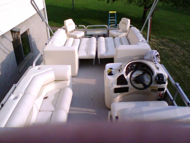

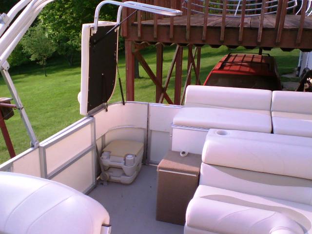

We used to tow and camp on our pontoon boat extensively. Actually every weekend throughout the entire boating season here. And yea we did have a new boat and purchased a full enclosure for her, and yes it was a pricy option even then. I'm thinking what will be most daunting or it was for us anyway is finding a boat with a suitable floor-plan for your intended use. In our case after extensive looking and shopping we ended up purchasing new.
The privacy curtain is missing in the photo, though it installed on the bar above the porta potty as seen on floor. And yes the wife did utilize it along with a lot of female guests to our boat.
Another nice option is seating that's utilitarian to both daytime needs and nighttime rest and comfort.
And from experience the above seats both slept and sat plenty well enough that we had no complaints.
Now on to size. The above boat was a 24 footer and it served our needs quite well. But that said I wouldn't have wanted it any smaller either simply because by the time the coolers, supplies, and the dog were loaded for an extensive outing the boat was plenty full enough.
