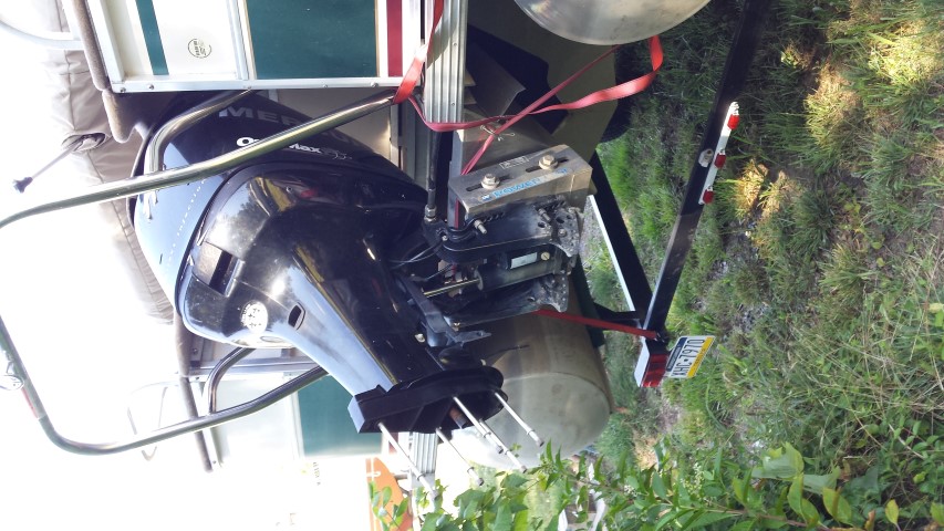

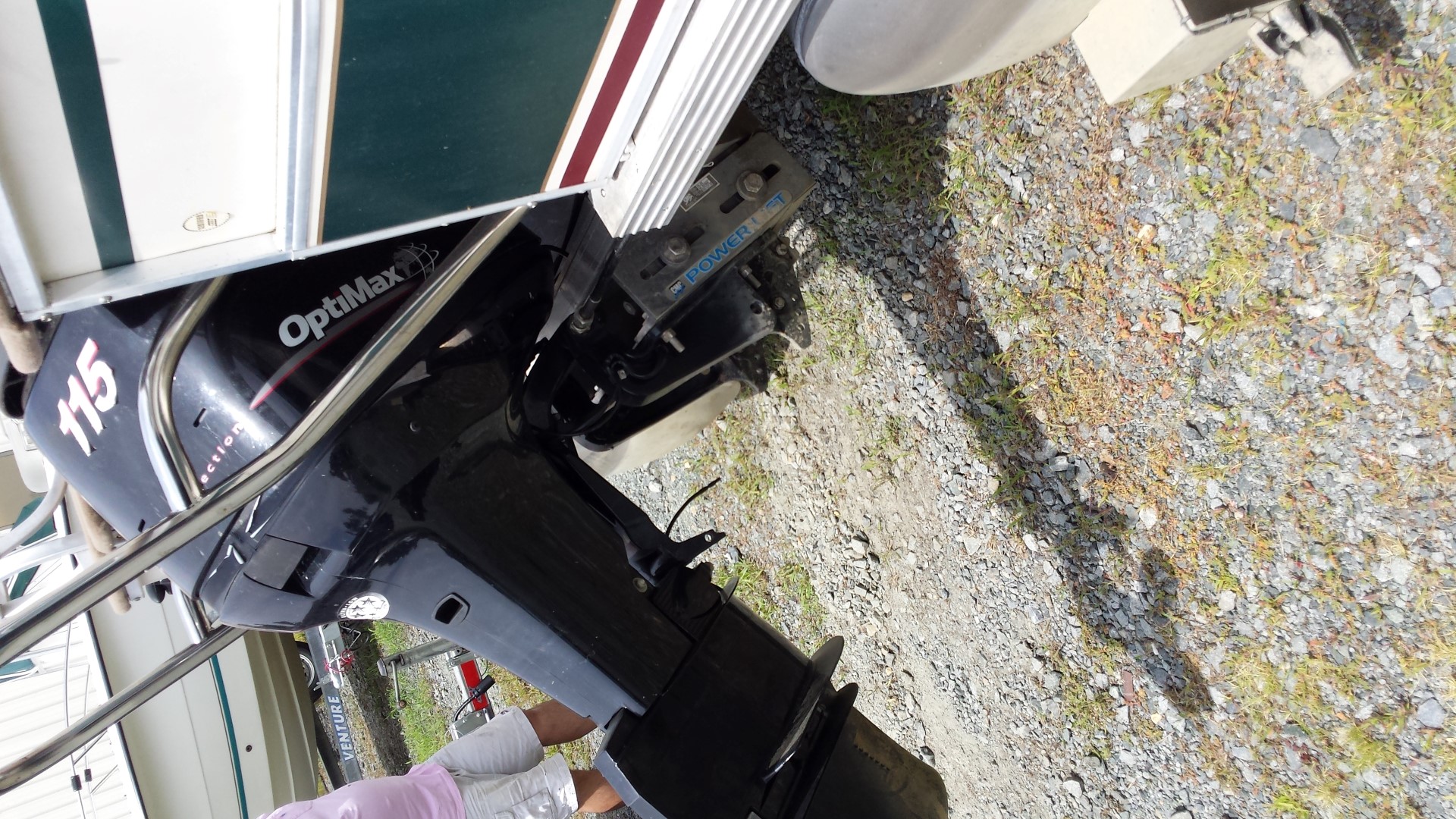

I find it a little strange as well. For someone to have taken it, they would have to take a boat out to my boat, on my mooring, and remove it, all without anyone seeing them. Here is a picture of my mooring taken from the dock. My boat is pretty far out there, all by itself. The marina said the plug was missing when they looked at it.
The other thing that drives me crazy. I have heard strories of people having their boats damaged when they are sitting at a marina, in the yard. So, to be safe, I took pictures of my boat, when they took it out of the water, before anyone even looked at it. I snapped this picture of the outboard. THE DRAIN PLUG IS AN INCH OUT OF THE PICTURE! If I would have panned left 2", I would have definitive proof that the plug was gone, it would be clearly visible in the picture. In the original picture, you can zoom in and see the fill plug. Why me!??! :x

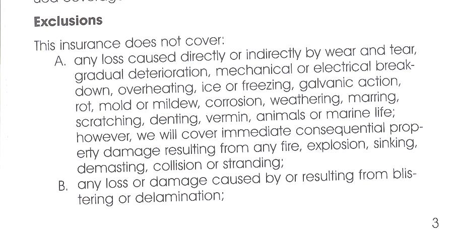

#9 Post by lightpants » Sun Jul 27, 2014 7:09 am
rockhound wrote:read your policy, i would call it vandalism, do you have comprehensive?
I read my policy line by line this morning. There is a list of exclusions, but I don't think it falls under any of them.
