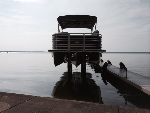

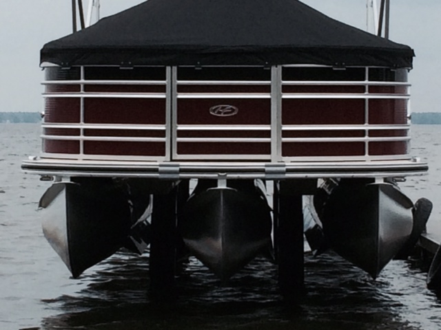

I have the Sea legs on a tri-toon and have had some strong winds and it hasn't affected it. How deep is the water where you will store it, I would think the lower you keep it stored the better. Here is a picture raised all the way up which is 6' from the deck and one with it lower.
- photo(16).JPG (75.18 KiB) Viewed 4648 times
- photo(11).JPG (97.54 KiB) Viewed 4649 times
2014 Harris 22' Solstice Tri-toon
