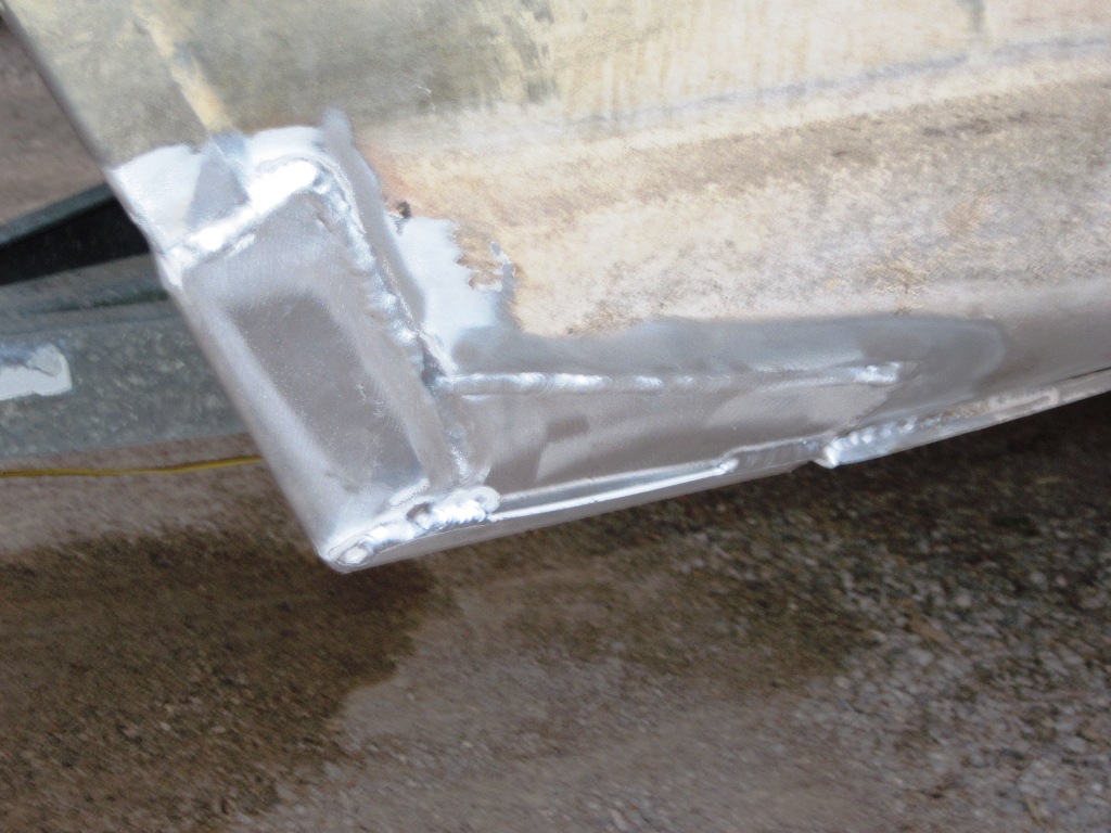

Had the exact same kind of leak on one of our toons a few years ago. Fact is we also had the same repair also and it held for a couple of years before it failed. :( So this spring we found a pretty good tig welder and had it repaired right.
Pontoon Repaire Raft 001.JPG (209.59 KiB) Viewed 1400 times
We had the bottom thinned out area of the pontoons overlaid with fresh new aluminum and tig welded in all around the parameter. He then spot tigged in a piece of aluminum angle on top of that for even more extra wear wear. Had him do both pontoons while he was at it, and he charged us a reasonable $200 for the job. So I'm thinking bring on the sand it's going to be quite awhile working it's way through these pontoons again. :thumbsup

Bamby.....that is were mine was too. but you got alot more meat on yours than I did maybe next time I will have them put some more meat on both of the toons.
$200 was a very good deal.
