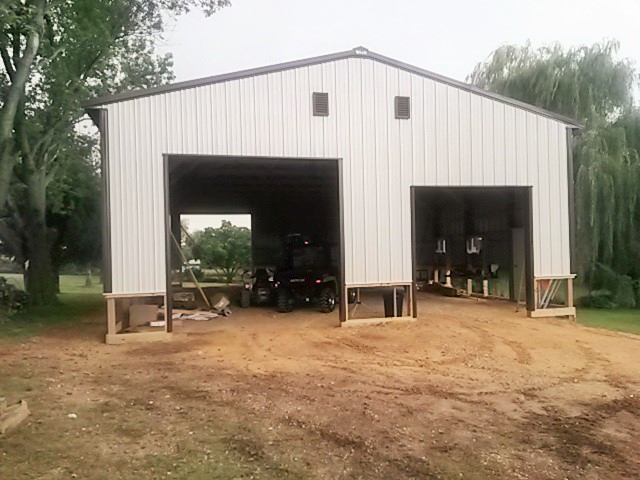

That's how my Manitou was when I first bought it, too. It was so low that you could feel the boats bow plow when getting into tall rollers. I raised it 2 holes and it helped it out a lot. Then after awhile I noticed how much different props, fuel and passenger loading was effecting the ride and performance. That's when I decided to buy the jackplate. Then you could adjust while driving. I can't wait until the new building is done, so I have a place and can find the time to play with the Premier. I've raise the motor 1 hole, it helped. But it needs a jackplate, too. Its has a lot more potential to be tapped out, yet.
