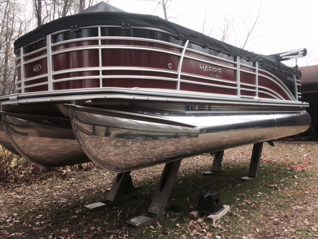

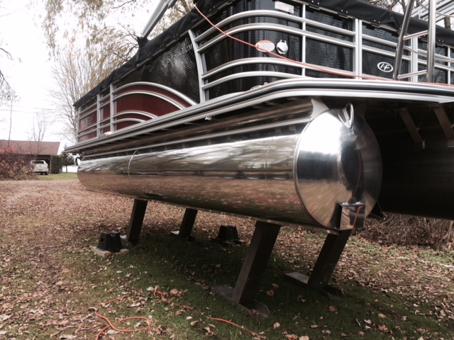

Finally got the pontoons buffed out, what a lot of work would not have started this if I would have known how much time and money it was going to take. Its hard to stop once you have half a pontoon shiny. It took 3 hours to clean the pontoons with lacquer thinner to get rid of the black, it didn't take much time to wipe on the 2 coats of Sharhide that was the easy part. What are you guys doing to repair the Sharkhide if you rub the clear off of a spot on the pontoon?

Re: Buffing Pontoons-How do you get rid of swirl marks
Looks nice!
But what the heck is it that your boat is supported with? Looks like it could tip backward pretty easy... I'm guessing that looks must be deceiving....
Those are called Sea Legs its 4 hydraulic legs that fold up under the deck or it can stand up 6' if I extend the legs full vertical.
I don't need to tie up when I park it somewhere or put in a lift at my cottage its all contained you raise or lower it with a remote control.
Oh ok now I see for what they are.... That is a pretty neat set up for working in shallow water. Not going to work too good on Lake Norris; I've got about 40' under me in the slip..... I'm hoping to afford one of them hinged trailer like lifts that you pump air in and out of the floats to lift the boat out of the water.garygve wrote:Those are called Sea Legs its 4 hydraulic legs that fold up under the deck or it can stand up 6' if I extend the legs full vertical.
Oh ok now I see.... Those are pretty neat for use in shallow water.garygve wrote:Those are called Sea Legs its 4 hydraulic legs that fold up under the deck or it can stand up 6' if I extend the legs full vertical.
