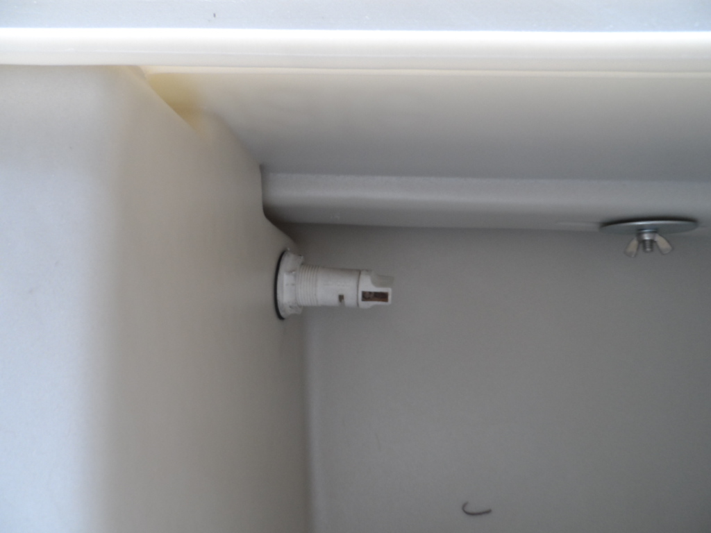

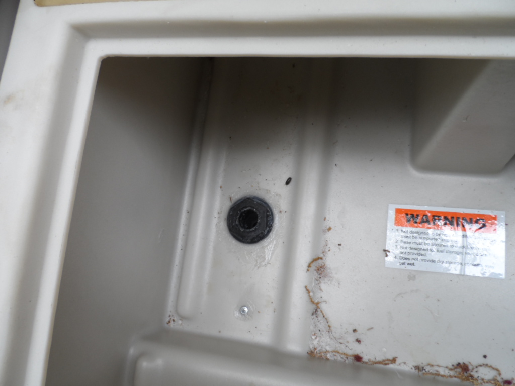

Make it yourself in the seat base. Seal up any screws cut a hole for the drain and fill nozzle your done.
- SAM_2746.JPG (282.7 KiB) Viewed 3267 times
- SAM_2748.JPG (277.81 KiB) Viewed 3270 times
- SAM_0970.JPG (285.76 KiB) Viewed 3272 times
- SAM_0969.JPG (272.14 KiB) Viewed 3269 times
Re: turning a pontoon seat into a live well?
Good idea, Did you seal the holes with fibreglass or just marine sealant?curtiscapk wrote:Make it yourself in the seat base. Seal up any screws cut a hole for the drain and fill nozzle your done.

I would suggest 3M 5200
