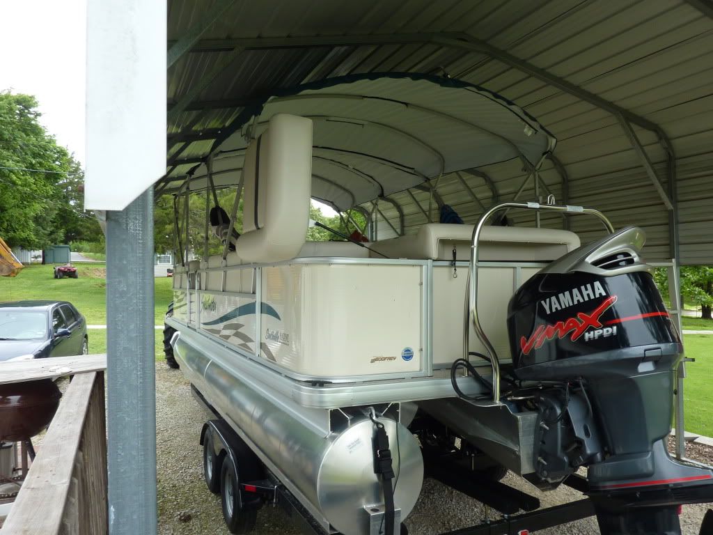

Ok so my parents want to buy a vehicle and want to have the ability to pull at least in a limited form the pontoon. They would realistically pull it maybe once every 3-5 years for maintenance/repairs only. Its a 2007 Sweetwater 2386 Sport, tritoon, with a (2006)150 HP Yamaha HPDI, and Tandem axle bunker trailer. From searchings online I can tell the engine weighs in at 468lbs. I have found nearly nothing online to figure the weight of the pontoon and trailer(probably looking in the wrong places). I realize these would be guesses and not official numbers(I am attempting to get my parents to call Godfrey and ask but thus far they haven't).

You're probably looking at 3000 lbs. plus a 1000 lb. trailer for such a tritoon. The total weight easily could go 4500 lbs. fully loaded
Pontoon/tritoons are relatively light for their size, however they tow heavier than they are due to poor aerodynamics and the length of the trailers putting stress on the tow vehicle. That boat might feel like it's well over 5000 lbs.
Most 1/2 ton trucks and many modern SUV's with V-6 engines can tow a pontoon when properly equipped. I just wouldn't want to tow one 200-300 miles or in the mountains unless my tow vehicle was rated for far more weight carrying capabilities.
I'm fortunate to have a 3/4 ton diesel pickup that's setup for heavy towing, but I can really feel my triton behind me.

That boat/motor/trailer is all of 3500-4000lbs total not including any gear.

So got a hold of Godfrey and they said the wet weight for the SW2386 Sport tri-toon is 2794 lbs(including motor).
