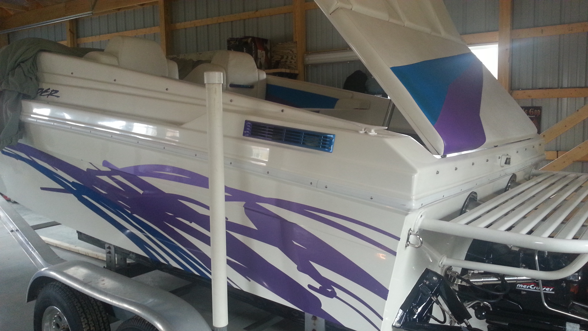

Just got done winterizing this......can't wait for spring!
