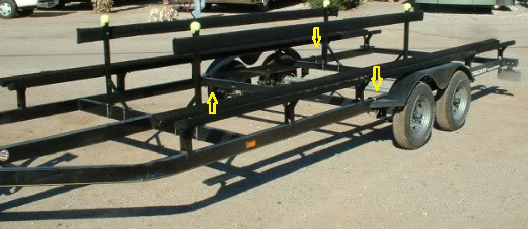

See Photo below and note yellow arrows:
Pontoon Boat Trailer.jpg (149.99 KiB) Viewed 2166 times
A lot of trailer manufactures mount their axles and suspension systems on a dolly like on the tracker trailer posted above. This allows for the dolly to be loosened and slid forward or backward some to customize the tongue weight of the entire unit. Yours also may be made in the same manner and adjustment will then be easy. Just loosen all the U-Bolts holding the dolly in place then jack up the trailer frame on both side in the back just enough to take most of the weight off the dolly. In general if you need to increase the tongue weight slide the dolly to the rear about 6" and then check, to decrease slide it forward 6" and check. Often you don't need to move them much to make a big change at the hitch but it's relatively easy so play around with it until you feel that it's right.
You then wont to check the brake lines to ensure they're OK and have enough movement or replace hose as needed, tighten everything back down and you'd be ready for the road again.

Hey, that's my trailer in the picture, I was not aware the axles could be moved. I need more tongue weight, gonna have to check that out.

That's exactly what my trailer looks like except it's a single axel.
