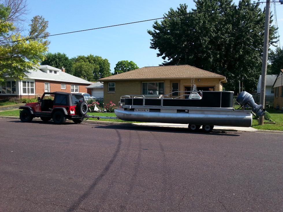

My 20 footer is a bit lighter but I've been using my TJ for the last 4 years with no problems. Mine is a six speed and never had a problem on the ramp but braking takes a bit longer. Not sure, but I'm guessing I'm close to the 2000lb towing limit.
- tow.jpg (176.93 KiB) Viewed 8756 times

Me thinks a different tow vehicle is in order, I would be most worried about stopping it in a hurry. Please be careful.

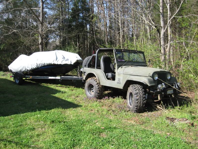

Honestly new jeeps are nothing more than a small truck anymore. They have a much wider and longer wheel base than previous generations .
Now I did this once against my better judgment ,62 cj5 2440 lbs with my fat hind quarter in it
