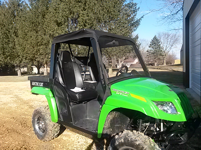

BobG wrote:Obviously, if you're going to put a big-block chevy motor in an Aston Martin convertible, you're going to have to do some engineering!
I'm kinda thinkin 425 horse 502 for the Prowler, myself.
