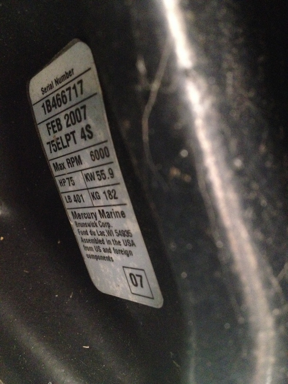

I need to get oil, filter and a water impeller for our 2007 Mercury 4 stroke. A few questions... Where is the best place to get these parts online? Well, maybe not the oil and filter but the other parts? Am I supposed to change out the thermostat? Is there such a part? Thanks so much for your help and suggestions.

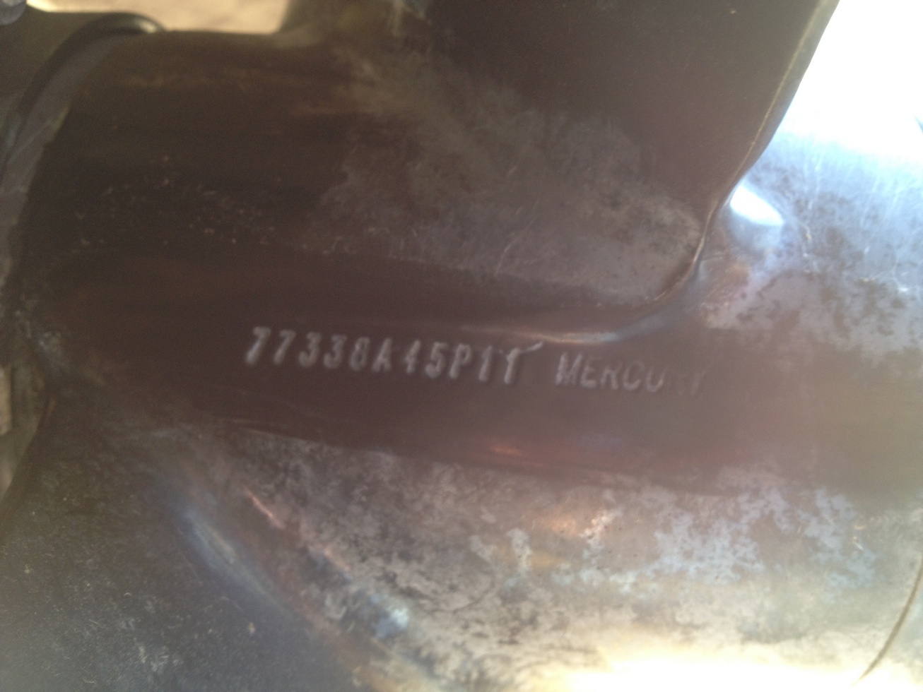

Also, I know it is gone over and over but what do you think about a new prop? The motor is supposed to have a 6,000 RPM limit... The best I have done is 6,200 RPM (?) at 21.8 MPH (GPS). You think I might be able to do better with a different prop? Thanks again for your help and suggestions.

On your propeller, is it beat up and the blades bent? How does it do handling loads of people? Are you often exceeding the 6000 rpm redline? If you're dissatisfied with the performance and it revs too high too often, going up 2" in pitch may be warranted. Aluminum propellers are relatively cheap to purchase.

Thanks very much for your reply and help... We are slipping at a very good marina this year. I might just ask him about the parts now that I have an idea of the prices. As far as our prop... It appears to be in fine shape (literally speaking...). Some of the paint is chipped away but all else seems well. I mention the RPM's because as the motor is turning 6,200 RPM's or so, the audible "over rev" beep is not sounding. I am wondering if my tach is OK as per another thread... Thanks for your thoughts.

I thank you again for your help and I now have a follow on question. I think I understand what prop to get now, Mercury Blackmax (same as I have just going up in pitch to next size) but I have a choice between "cupped" and not... Everything I read on cupped props says it bites better and increases top speed... It doesn't say any "negative" comments. What is the difference and why wouldn't I/shouldn't I chose "cupped"? Thanks.

A cupped prop, is just that. It has a slight cup in each blade to "catch" more water. That is what you want on a pontoon. Pontoon's like big eared props with cup, or extra cup. It will also help with low RPM response.justrfb wrote:I thank you again for your help and I now have a follow on question. I think I understand what prop to get now, Mercury Blackmax (same as I have just going up in pitch to next size) but I have a choice between "cupped" and not... Everything I read on cupped props says it bites better and increases top speed... It doesn't say any "negative" comments. What is the difference and why wouldn't I/shouldn't I chose "cupped"? Thanks.

Thank you for your reply... I see you have almost the exact same set up as us (assuming you don't have 3 toons...) except our boat is a 20'. What prop are you running and what speed/rpm are you seeing? We currently have the Mercury Blackmax with the 11" pitch. With 2 or 3 people, we run 6,100 - 6,200RPM with 21.8 MPH (GPS) best performance. I am wondering if I go to the 13" pitch and the cupped blades, it might be too much. What do you think? Thanks very much for your help.

I get very similar numbers. I run a 11p extra cup mercury prop.justrfb wrote:Hello kryptonite.

Light loads, I see around 6000 RPM, and 21 mph.
Heavy loads, 5500-5800 rpm's and around 18 mph.
I have a cheap solas prop for a spare, and I tried a 13p. It's not an extra cupped prop. It didn't perform very well, It dropped WOT down to 5500 on a light load, but with several people it was lugging the engine too much. It did not improve speed.

Thanks for your answer... I am a little worried now because I ordered the 13" pitch cupped prop. I am wondering if I should not open it and get the 11" pitch cupped prop. Any thoughts on this guys? Once I mount a prop, it is mine. Can't go back and can't be exchanged... Thank you.

Your boat is shorter and thus should be lighter than mine. If you normally only have light loads, I'd say you would be fine with the 13p, but if you normally have a boat full, I'd opt for the 11p.

Thank you. I am going to put on the 13" pitch cupped prop
