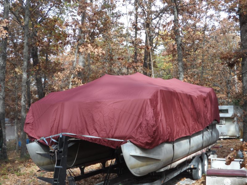

I have this cover it is awesome! It will only work on a trailer though.Big had wrote:Yeah. It was showing above 6k on the rev and I was kinda concerned but also shrugging it off as normal. It had more to give. I think I need to take a more detailed look at it. I was not full throttle either. Perhaps the tach is wrong or was acting funny like the gas gauge was.

http://www.pontoonstuff.com/collections ... oon-covers

That is a nice cover. Yes it is on a trailer and lives on the side of my yard except when I am towing it somewhere to use.
Where did you get that?
