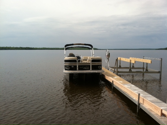

Here is a pic of the hoist I purchased for our tri toon. What makes me a little leary is that the deck of the boat is 26ft and the hoist boards that support the deck are only 16ft. I was informed by the boat manufacture that is acceptable as long as the majority of the stern is supported? So when I hoist it at night, I have about 3-4 ft of rear overhang of the deck in the rear. So far so good. If I would have purchased the bunk system to support the logs instead of the deck, they were only 10 ft long? For my former 2 log pontoon boat I had a cantilever style of lift that supported the entire deck. I wish I could have found that type of lift to use for the tri toon, but the center log just would not fit with the cross bracing.

Sorry to drag up an old thread but how has that lift been working out with your tri toon? do you have any pictures of how far forward you have the boat on that lift? or just pictures of it on the lift? Thanks a bunch, we just got a cantilever lift that lifts from under the deck and I just want to try to figure out approx. how far forward we need to pull before putting the lift up.

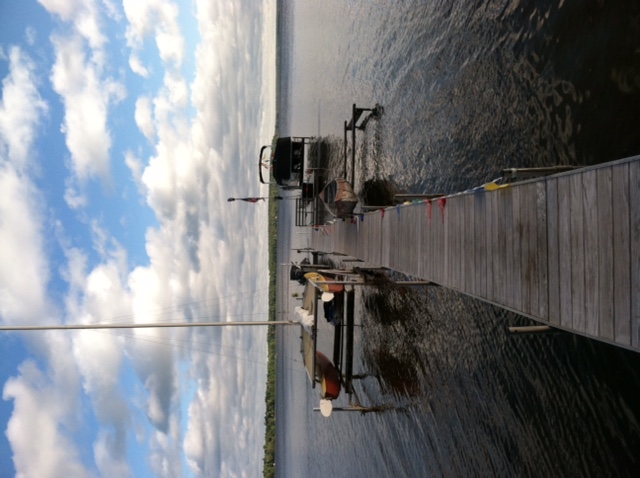

This is all the pics I could find on my phone. This is our third year using this hoist and have had no problems. The boat is 26.5 feet long, Tritoon and the hoist deck support boards are 16 feet long.
- hoist 2.JPG (103.58 KiB) Viewed 6142 times
- hoist.JPG (30.23 KiB) Viewed 6137 times
