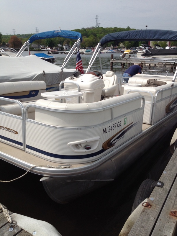

I need your opinions and help please... We just launched "Da Boat". 20' two toons, 75 Merc 4 stroke hanging off the back. I had a BlackMax 14" X 11" prop on last season. 2 adults, 10 gallons of fuel, we ran 6,200 RPM @ 21.5 MPH. This year, today, 14" X 13" Cupped new prop, 2 adults, 25 gallons of fuel, we ran 5,350 RPM@ 21.7 MPH. Suggested RPM for our motor from Mercury is 5,000- 6,000 RPM. Is it too much prop? Should I go to an 14" X 11" Cupped prop? I am not sure they will take the one I have back. I would hate to have to buy a new one out right... What are your thoughts and suggestions?

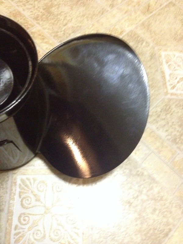

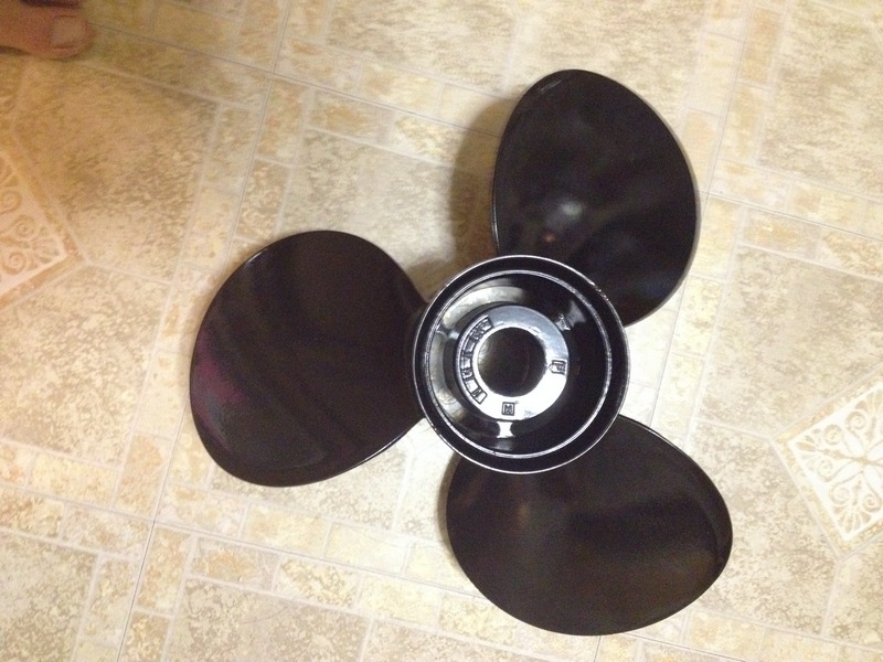

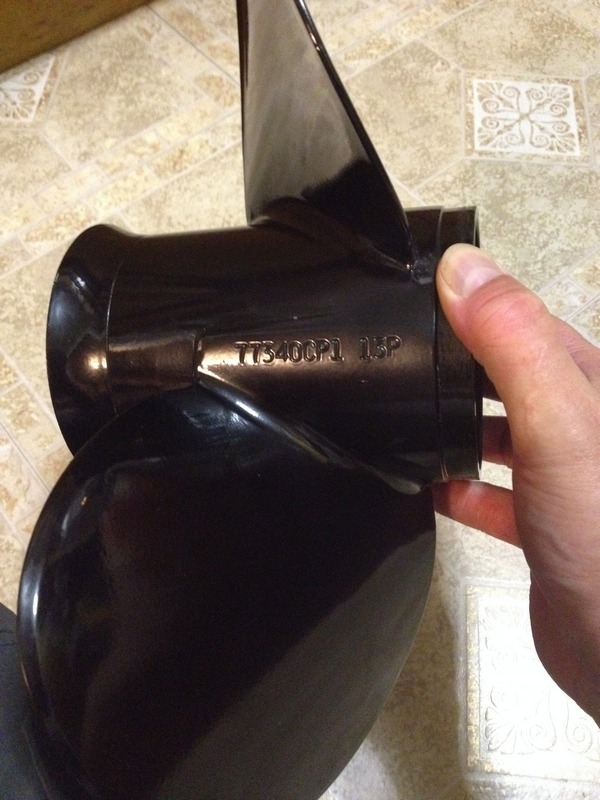

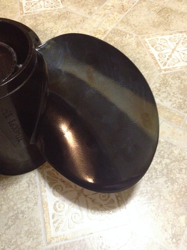

I took delivery of our new 11" cupped prop, got the 13 " cupped off our boat and put the 11"cupped on... Perfect numbers... 5,900 RPM @ 21.4 MPH.
!! I had the 13" cupped on my boat underway for about 15 minutes total. I have someone from the list who might be interested but if he isn't, you good people on this list have helped me so much, you have second dibs... ($100.00 plus shipping) The unopened Flo-Torq III from the 11" prop included. 100% satisfaction or send it back for your money back. If no one is interested, I will list it on Craigslist. THANK YOU for your help.
