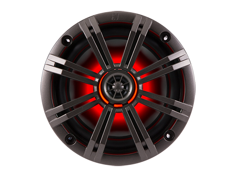

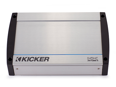

The Premmie has a blown speaker and I'm thinking about replacing them all with a 4 pack of these and may as well pop in an amp while I'm at it. I'm no stereo guru so I need some help, guys. Are these decent speakers? I don't want to overdrive them with too big of an amp, would a 400 watt amp do the trick or should I go 800? I'll be using my existing radio. Here are the specs of what I'm looking at

KM 6.5" 4Ω LED Lit Coaxial
Speaker specs...
KM654LCW Specifications
Woofer(in,mm) 6-1/2, 160
Tweeter(in,mm) 3/4, 20
Tweeter Dome Material Titanium
Rated Impedance(Ω) 4
Peak Power Handling(Watts) 195
Continuous Power Handling(Watts RMS) 65
Sensitivity(1W,1m) 90
Frequency Response(Hz) 35-21k
KX400.4 Amplifier Specifications
Power (watts/ch), Full-Range Class D 2 Ohm stereo 100x4
Power (watts/ch), Full-Range Class D 4 Ohm brdgd mono 200x2
Remote Bass Control (included) No - Not Applicable
Dimensions: 2-1/8 H x 8-5/16 W x 11-3/16 L (in.)55 H x 210 W x 284 L (mm)
Frequency Response (Hz): full range 10-20k (KXM.5 sub ch. 10-160) ±1dB
What do you think, would this work? Or should I look at other options of speakers and amps.....
Thanks in advance!

I've not run those speakers, but the amp going by the specs is well matched its 50 W RMS/channel and the speakers are rated for 65W so no problems there.
