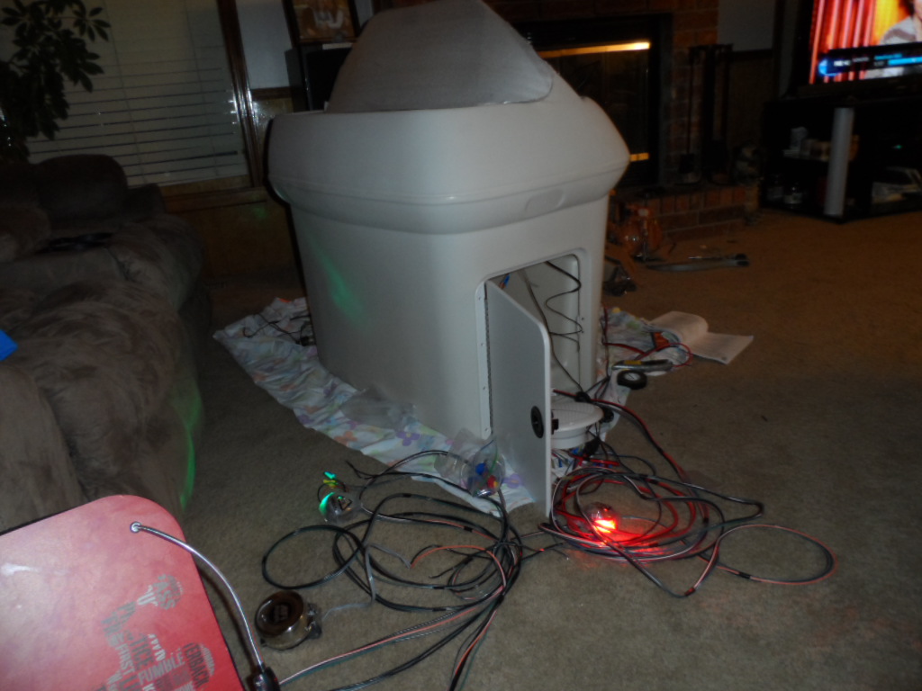

I think I figured it out. While it looks it like the back SHOULD come off, it's actually riveted together under a rubber seal. However, on the back side there is a glove box. I was able to pull the 4 screws holding the glove box and that opened roughly a 12x6 hole that I was able to use to get in there to access the stereo. For the gauge access, I think you would still need to unscrew the gauge pane from the front of the console. Here are a few pics.
Any other conclusions based on the pics?

Re: Removing the backside of a pontoon console?
yep you figured it out! Panel screws for gauges and the four screws on the stereo will let you remove it as well.

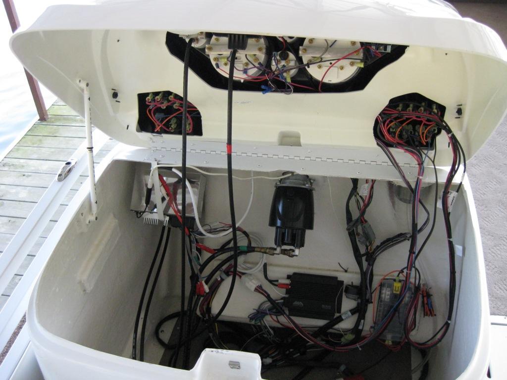

Here's my access to the goodies -
- Neptoon Sunlounger inside console.JPG (96.42 KiB) Viewed 2743 times

The access is not ideal, but I think I can make it work. Despite being able to pull the stereo out via the 4 screws in the front, I did still need access from the other side to remove the aluminum support strap and to splice the speaker wires into the new adapter for the new deck.
I wish i had access like OldePharte does, that would make things WAY easier.
