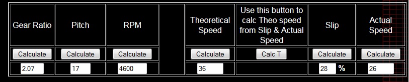

Tom,
My current speed is 26 MPh @4900 rpms. All that with a mercury 15x17P prop (that's what it came with)

Re: 22' Suntracker DLX Fishn Barge - 2015?
Mike,
Attached is what the slippage calculator came up with. Your stats shows 28% slippage and 4600 RPM WOT is way low. Slippage should be around 12% and WOT at 5500 -6000 RPM
Play around with this and see what you come up with.

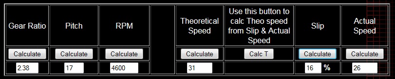

I must not be holding my mouth right (LOL) every time I use the calculator and hit calculate I get "Nan"
My gear ration is 2.38:1 Pitch 17 rpm 4900 actual speed 26 mph.
A little help?
Enter Ratio, Pitch, RPM and Actual Speed. Click Theoretical Speed calculate then click Slip calculate
I show 16%. Gotta hit the tho speed before slip.
[Edit] I entered wrong RPM, now showing 21% for 4900
I see, I must be missing something. Can't duplicate your results.
I'll keep trying.
