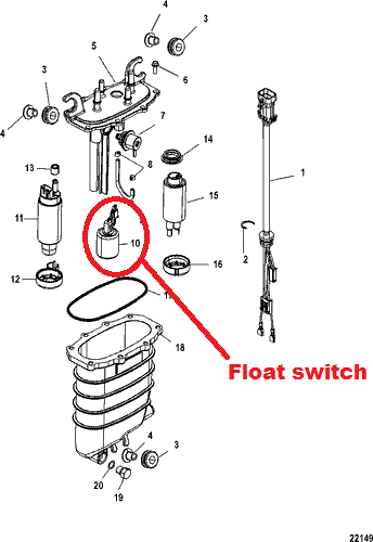

Rich,
If you you determine that you have a WOT or partial throttle issue and it feels like the engine just starves for fuel and wants to sputter and die, the fuel float switch (Part #10 in the attachment) is the most likely cause. I had this happen years ago and it was replaced under warranty and it has run great since. However, if I need to replace one again, I will do it myself since it looks rather intuitive. Word has it these are a common issue on Merc four strokes.
My problem is definitely not a fuel starvation problem since it only happens transitioning to idle. I am leaning towards a gunked up IAC (Idle Air Control) valve. I plan on purchasing a new one and trying to clean the existing or just simply replace it. Does anyone have any knowledge of IAC valve issues causing stalling?
