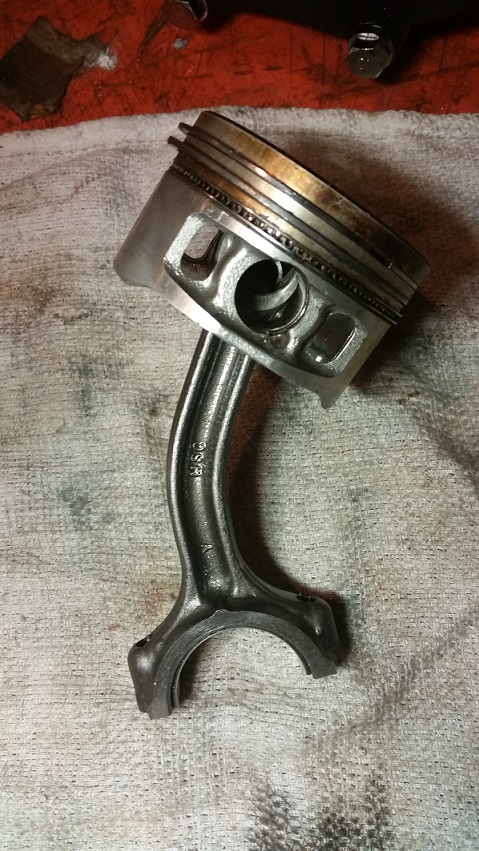

#4 Post by Xscash » Sat Oct 17, 2015 2:02 pm

Holy crap talk about a severe case of Hydro-Lock there....

teecro wrote:Holy crap talk about a severe case of Hydro-Lock there....
Yep! This is a 60Hp merc 4 stroke that ingested water at full throttle. No damage to cases or top end. 4 hrs labor and $150 in parts. Great afternoon repair.
