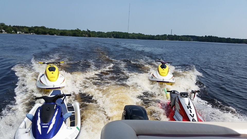

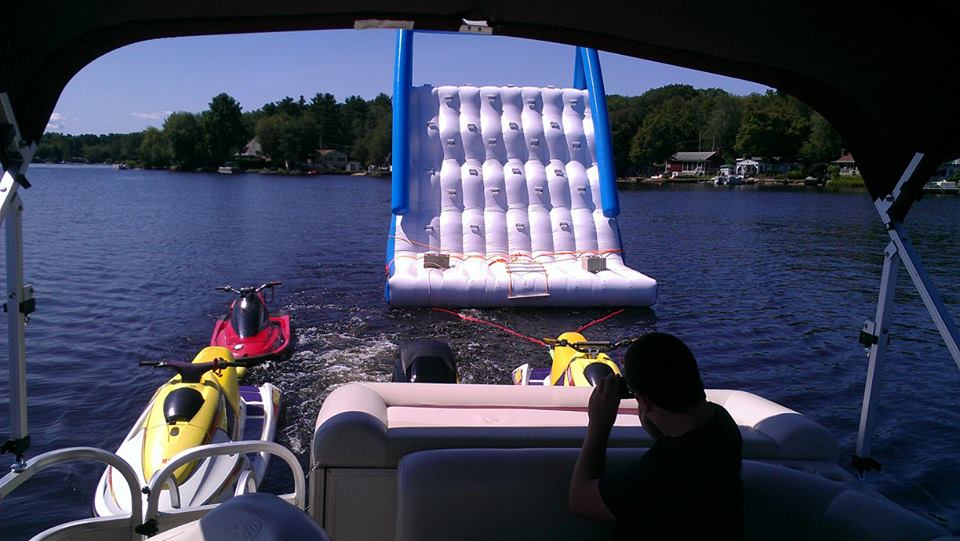

We always bring the toys! These boats are perfect for exactly what you want to do!!! I made 3 point tow bars from pvc pipe and noodles with ropes through them. They attach to the back of the pontoons and the engine pod keeping the skis away from everything and tracking directly behind each pontoon. works awesome.
- skis behind boat.jpg (89.81 KiB) Viewed 3973 times
- boats and toys.jpg (83.27 KiB) Viewed 3976 times

super cool. i've seen lots of folks towing skis, but never a rock wall/slide.

I love the rock wall/slide! I've never seen anything like that!!

Look, you guys can take whatever advice you want. I was a jet ski racer for many years and a mechanic for many more. I have both closed loop and open, as a matter of fact....all the skis pictured in my photos are open loop. You can see the speed in the first shot. If you do not exceed 20 mph, it's fine. most of the pontoons wont pull skis at over 20 anyway.jafo9 wrote:the 20mph may be true for some ski's, particularly with closed loop cooling. but both yamaha sit downs, one kawasaki sit down, an older sea doo and 3 stand ups i have owned all had a manufacturer warning not to exceed 5mph on towing. definitely want to check with the manufacturer. as noted above, the risk is pushing water back into the motor and filling it with water. first comes the hydrolock then the rust. not such a big deal to clear a flooded 2 stroke, but a 4 stroke is a big deal.
