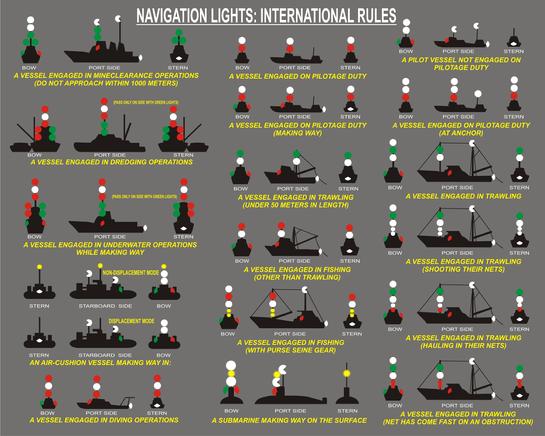

ARS 5-333.F No watercraft may display a blue light of any size or type unless it is either an authorized law enforcement watercraft of the federal, state or local government actually engaged in the enforcement of this chapter or an emergency watercraft.
Federal law prohibits flashing blue lights on anything but law enforcement. While the blue led light strips some use may not flash, their location on the boat (under deck) may make them appear to flash when the boat rocks in waves or wakes.
There is more to navigation lights than just red/green bow lights and a white all around light. There are literally dozens of light configurations to indicated any number of boats/ships and their activities. Here are just a few. While this is for International waters, those required for Inland, Great Lakes and Western Rivers (Mississippi, Missouri, etc) are very similar.
- 545_NAVIGATION_LIGHTS_international_rules_003.jpg (43.84 KiB) Viewed 14951 times
