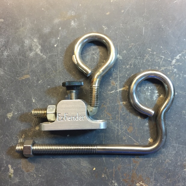

If the upload worked, here are 2 pics of ideas I had. The only place I can add a rear cleat is thru the rail at the base of the fencing. Bryan made me a couple of EZFenders with 3/8" holes. I heated and bent the 3/8" SS eye bolt then drilled an indentation in the threads where the thumbscrew touches the eyebolt. This is to lock it in place in the raised (folded) position.
I made the longer eyebolt in case the EXF doesn't work as well as planned. I plan to thread the longer eyebolt up nearer the eye to gain as much length as I can to attach lock nuts underneath the deck.
I plan on using SS lock nuts on either design I go with. Both are designed to fold out of the way when not in use.

I have since threaded the eye bolt even with the bottom of the eye. I plan to add a SS lock nut and flat washer at the top where it rests on the tubing. I may superglue the washer to the tubing or add a Teflon washer beneath the flatwasher to prevent wear on the tubing.
Below deck, I'll probably add a large SS fender washer or a square of 1/8" thick aluminum (or both) to reinforce it.

I missed your Q. I hadn't thought about putting a spacer under the tubing. It may be possible to add a nut and washer under the railing or some other spacer. I don't think there would be any compression. I was more concerned about possible enlargement of the hole on top of the tubing or bending of the tubing. We typically only tie up the stern briefly when launching or returning to the dock, so there's not much pulling on it.
My boat came from the factory with an eye bolt on each side in the rear for tie ups. I want to replace them because there is so little room to thread a rope thru the eye. Using them has not affected the tubing.
The better alternative may be to go with the EZFs.

The OEM eyebolts bolt thru the fence and the deck. I was thinking of just replacing the existing OEM eyebolts with the bent ones in the above pics just to make it easier to thread the rope thru them. I made aluminum backer plates for the bolts below deck. If I used the EZFs, they would also be bolted thru the deck. Nothing would be attached solely to the fence.
