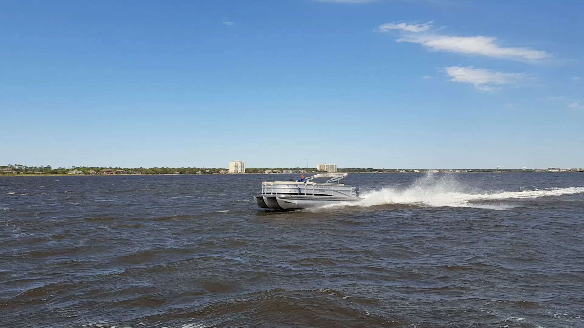

Just raised the motor one bolt hole, second from the highest setting, and running the 14.5 X 15 Yamaha Reliance prop, 5900 RPM at 38 MPH in good 2FT confused chop. She was skipping across with a smooth ride, didn't even spill a drop of beer

Yes, St. Andrews is beautiful, been there a few times, once we stayed in the park with our motorhome, and I had my old chris craft cuddy with us, great fishing offshore from there. Also, yes on the dialed in, its about where it's gonna be, I tried a 14P Enertia prop, but the diameter is 15 1/8" RPM was about the same as the reliance, but I lost a little speed, I think the slip ratio was a little higher on the enertia because of the reduced pitch, it held a little better in rough water, never tried to blow out (aerate) where the reliance will definitely blow out if you trim up more than about 50%, but the enertia has a huge rake compared to the Yamaha.
