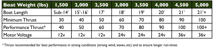

Here's some info
My toon is 25' 8" wet weight 3423 lbs. I did a lot of searching on forums and even called Sweetwater before purchasing a trolling motor.
I was surprise when Sweetwater expressed to me under normal conditions a 45" shaft and 55 lb trust trolling motor should be adequate.
I was hopeful my Internet searches would support this statement because of cost and battery requirements, but at last they did not.
If you can get the results you need with a smaller motor than certainly it's the way to go.
In my case I know the 55 lb 45" shaft would not have performed as needed.
I ended up with a Minn Kota Terrova 80/US2 80-lb Thrust Freshwater Bow Mount Trolling Motor with i-Pilot, 60" Shaft.
This unit does a nice job even in 15 mph winds, however the best I can hope for is around 4.7 hours of continuous running at 2.4 mph and less time in 15 mph winds, using two group 27batteries.

Here's some info
I love my i-Pilot, 60" Shaft system.
