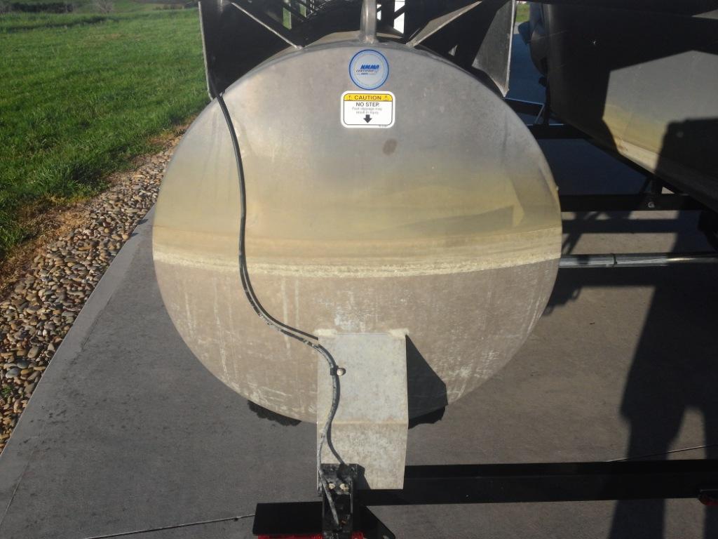

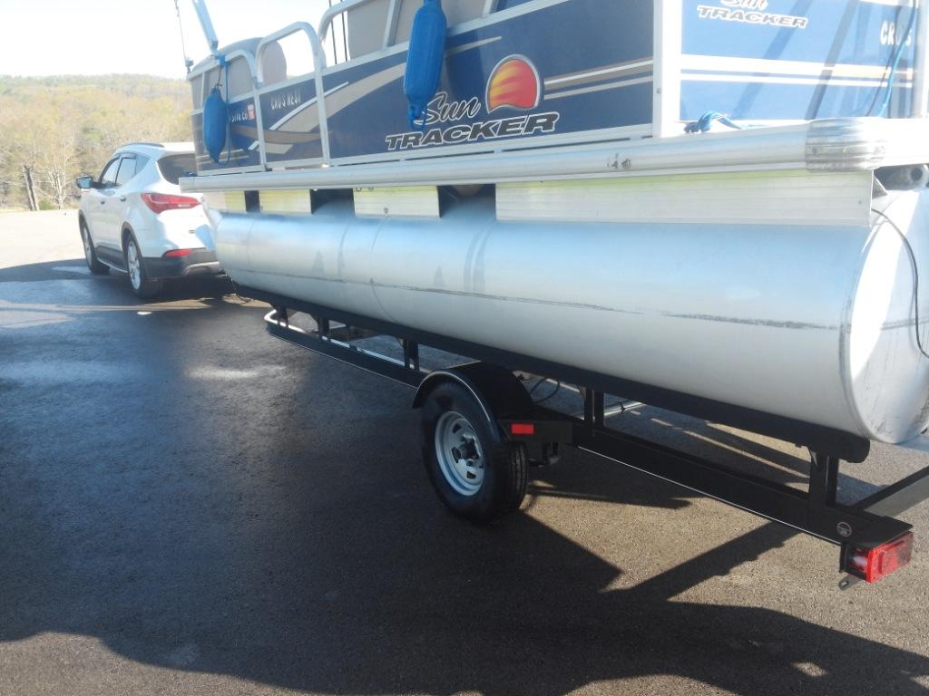

NAPA Alum Brite sprayed on full strength with a big sprayer will flat bring your finish back to a shiny but near white finish; or at least to say the whiter side of silver. Beyond that if you want SHINE it all boils down to elbow grease and/or a polishing compound and a buffer... Only there will you find a high shine but then you MUST protect that high shine with something akin to SharkSkin...
These pictures are before and after with only AB50 sprayed on and off nothing else. To get a more even appearance I would have simply done a 2nd or 3rd coat but I was running out. Keep in mind this is a boat that while only 2 years old it stays wet 24/7/365
after aft.jpg (107.47 KiB) Viewed 1772 times

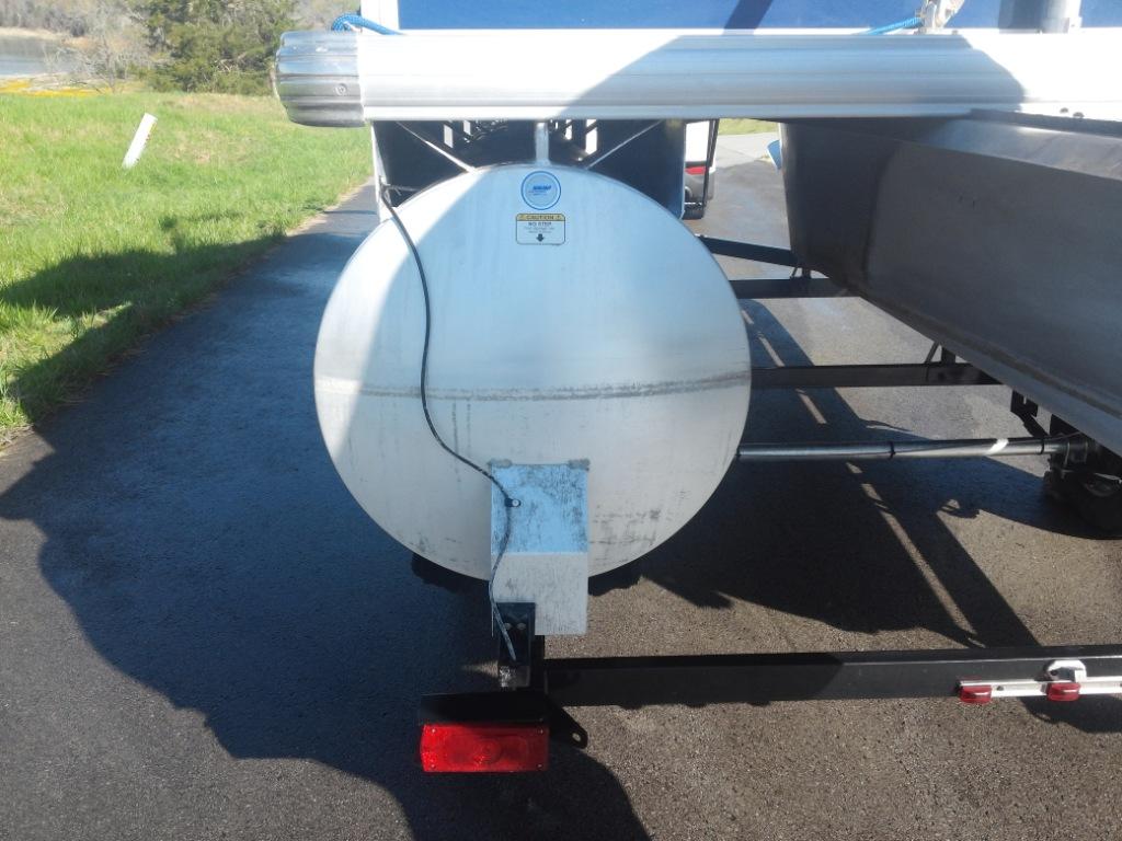

#3 Post by teecro » Fri Apr 22, 2016 4:58 pm
A couple more...
