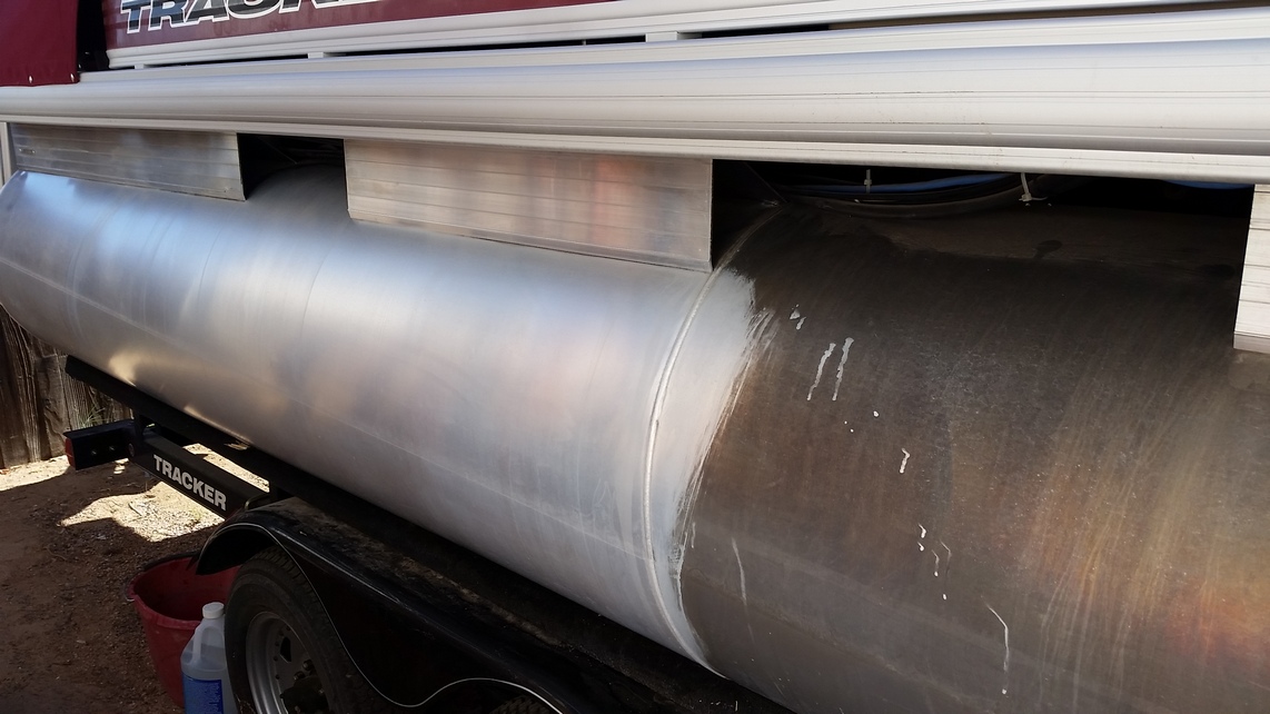

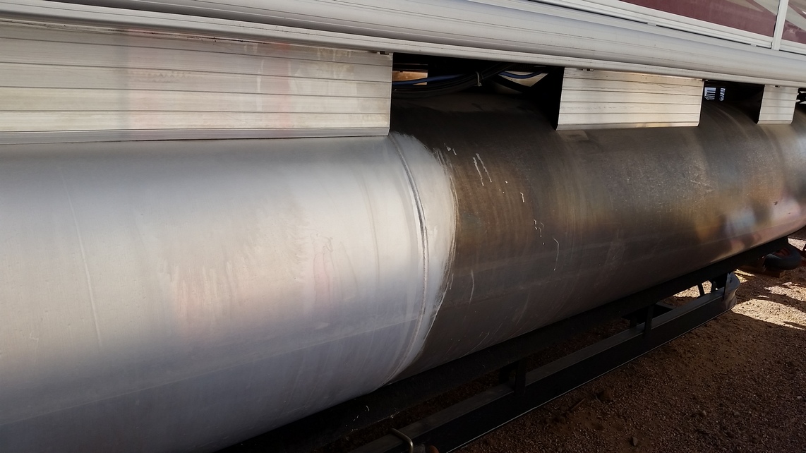

Started cleaning up the toons using NAPA Aluminum Brightener. No polish (yet). Here's the side by side comparison.
Anyone know if polishing will take out that line at the waterline? Maybe hitting again with the acid?

That water line looks light enough that it 'may' polish out. Mine was bad enough that it did not. I did not even try to polish under the water line. It gave my toons a two-tone look that I kinda like.

I wasn't able to get rid of the line on my Sun Tracker, but I was able to reduce it with polish. I tried multiple applications and couldn't get rid of it. It was worse on the back flat side by the motor, didn't look too back on the sides.BoatCop wrote:Started cleaning up the toons using NAPA Aluminum Brightener. No polish (yet). Here's the side by side comparison.

I used the Napa product full strength right out of the jug and applied with a chemical resistant spray bottle. Laid it on thick , let it set about a minute and a half then pressure washed it off. My toons were not real dirty to begin with as kept on a lift, but the difference was amazing! did each log twice and removed the waterline mark pretty well. Once its in the water you wont see the line anyway.,..

If it won't polish out, go to the automotive paint section and get some 1000, 1500, and 2000 grit paper and wet sand it out. A followup with polish will easily eliminate the fine marks from final wetsanding with 2000. This is how I removed one nasty scratch from mine when the DA and the rotary plus wool pad wouldn't take it out.Cowracer wrote:That water line looks light enough that it 'may' polish out. Mine was bad enough that it did not. I did not even try to polish under the water line. It gave my toons a two-tone look that I kinda like.
