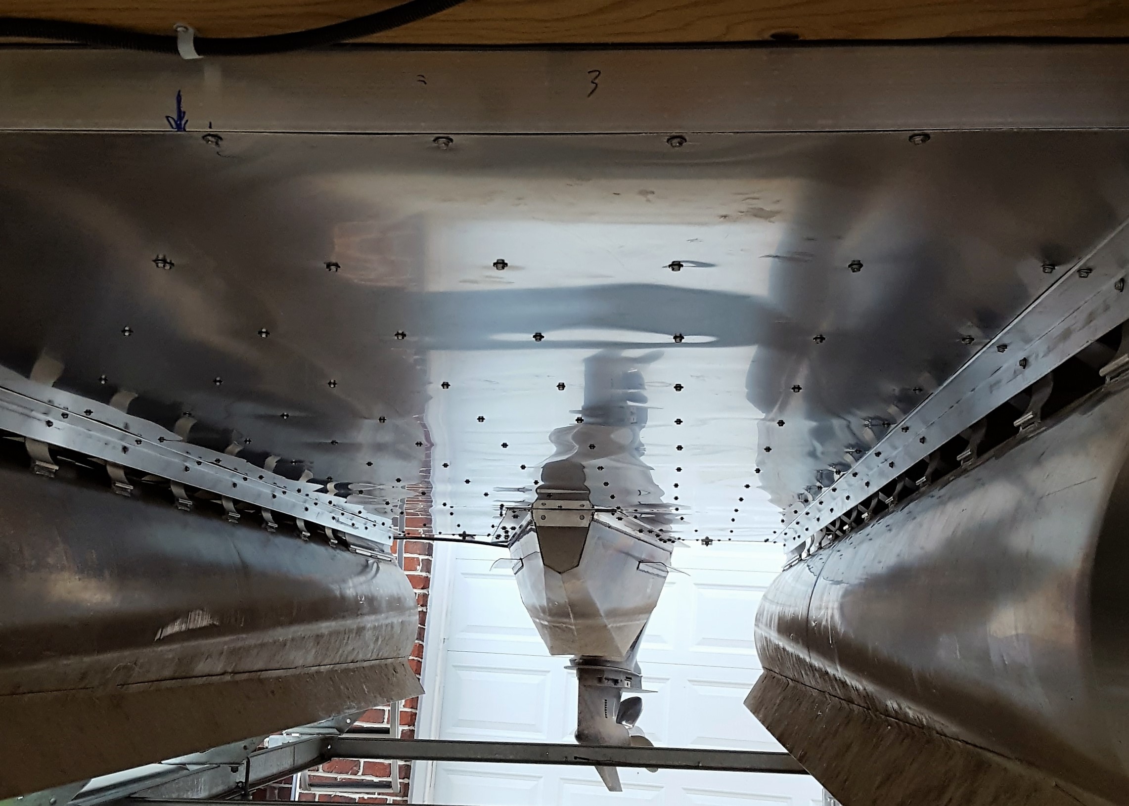

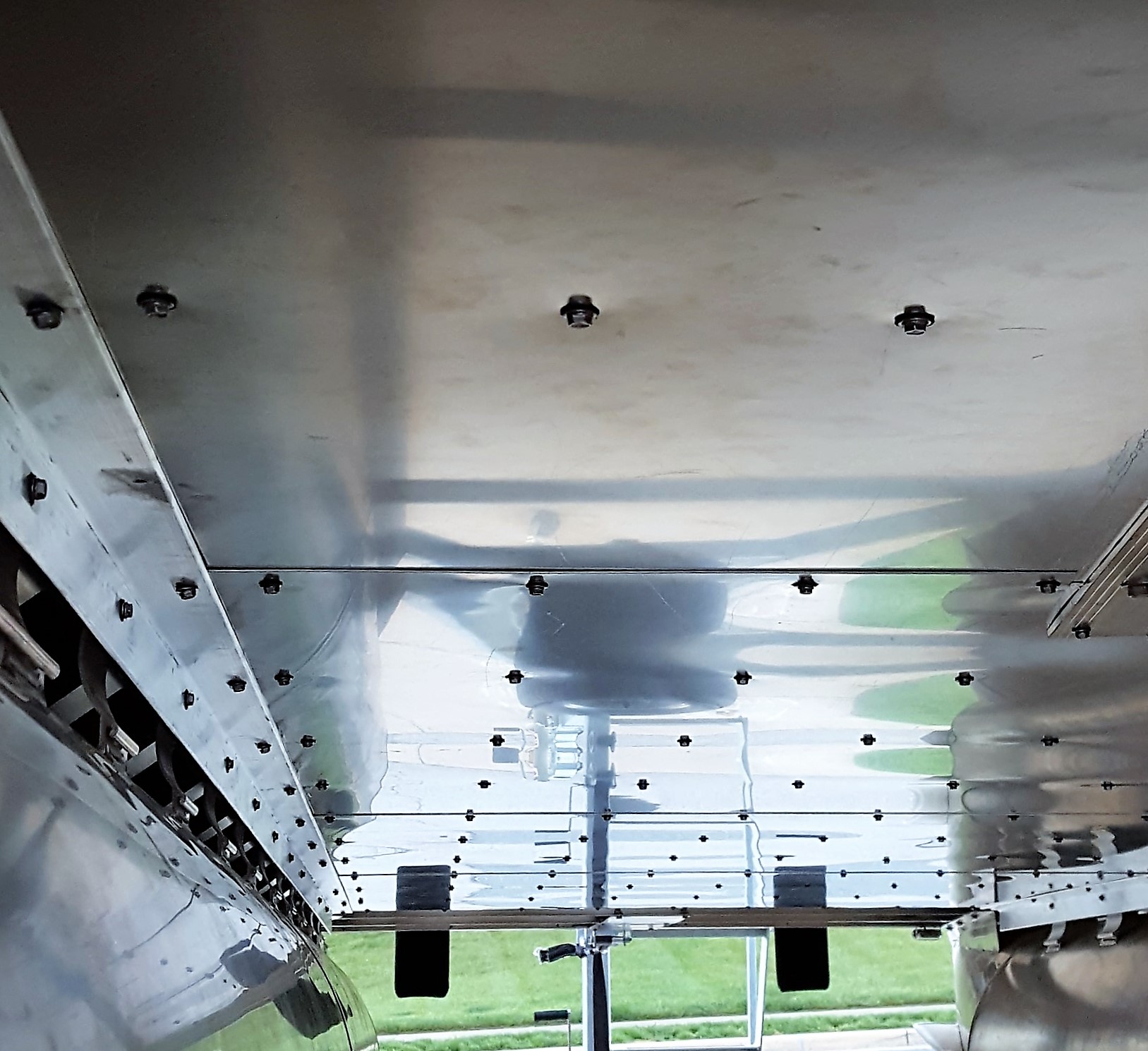

Well the underskin is done. Turned out pretty good. 17' covered. Smacked my head a bunch under there. Sore from the body position working the material. One of my Sons-in-Law helped me with the 66" sheet. The rest I put in using some 2"X3" T's that I used as jacks to hold the edges up. What works very well in holding the sheets up in place is duct tape. C-Clamps are good for the angle Iron. (Don't mind the grung on the pontoons... my Marina, left the boat in the water for a while after I asked them to pull it and store it for the Winter. Powerwash is up next.)

OK here's the BEFORE measurement 22 MPH, actually being more precise, 22.4 MPH measured by GPS. AFTER: I made some performance runs today and loaded the boat up with all my gear, some water in ice chests to simulate more weight from people and tried to get it close to the weight for the 22.4 MPH BEFORE run. I made GPS runs back and forth on the same GPS track to take out any wind or current variations. With the wind 25.0 MPH into the wind 24.4 MPH, average is 24.6 MPH. Now I think I'm about an adult and a half shy in terms of weight (300 lbs), but still at least 1.5 MPH maybe 2 MPH increase, accounting for less weight on the boat. As far as ride ,that is where it shines. Quiter, no surging over wakes... I also noticed I have a blast of water come out the back of the boat... probably because the sheeting is allowing it to flow back easier. I might put a GOPRO in the front and see if I can observe anything.
