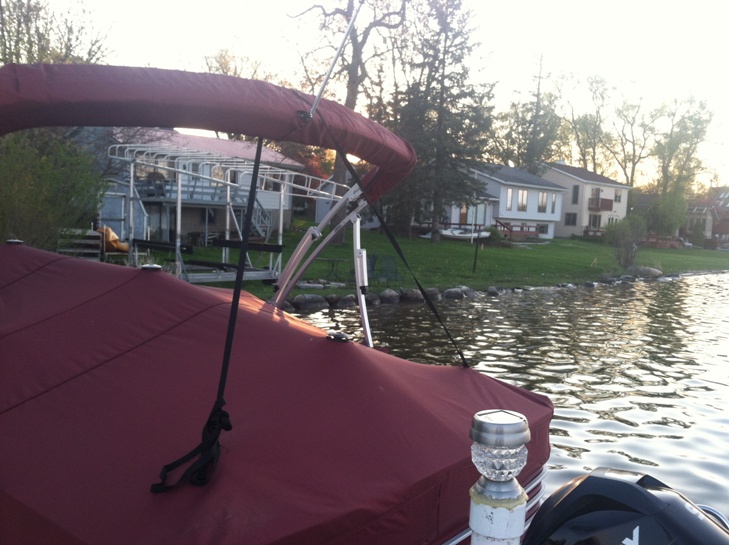

The mooring cover on our new Bennington came with a 20' adjustable strap (just like on a life jacket) sewn into the right rear corner, the male end goes over the Bimini top, and snaps into a female buckle sewn into the left rear corner. Adjusting (tightening) the strap lifts both rear corners of the cover and has completely eliminated the pooling of water in the rear corners. It works great.
If you do have a new cover made, do your self a favor and have your cover shop install a strap.

Yes, the strap is awesome. Thanks for sharing!!
