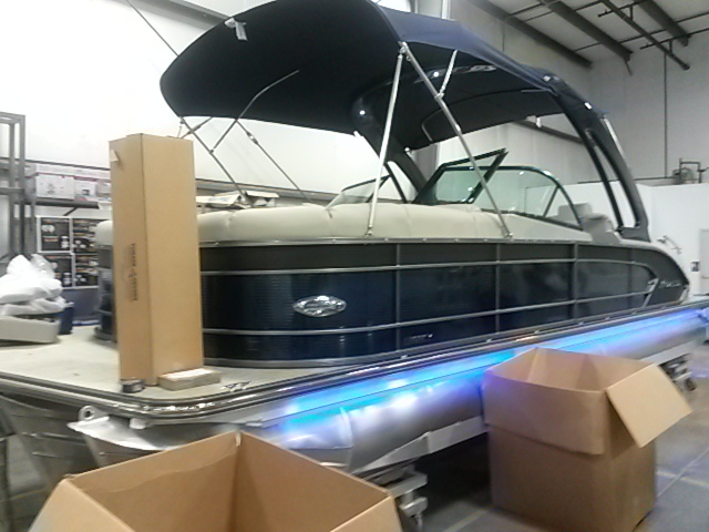

That's how my front bimini is mounted on the Manitou. It rests in a forward position. You may want to talk to Sylvan to make sure, but I don't think there would be a problem.

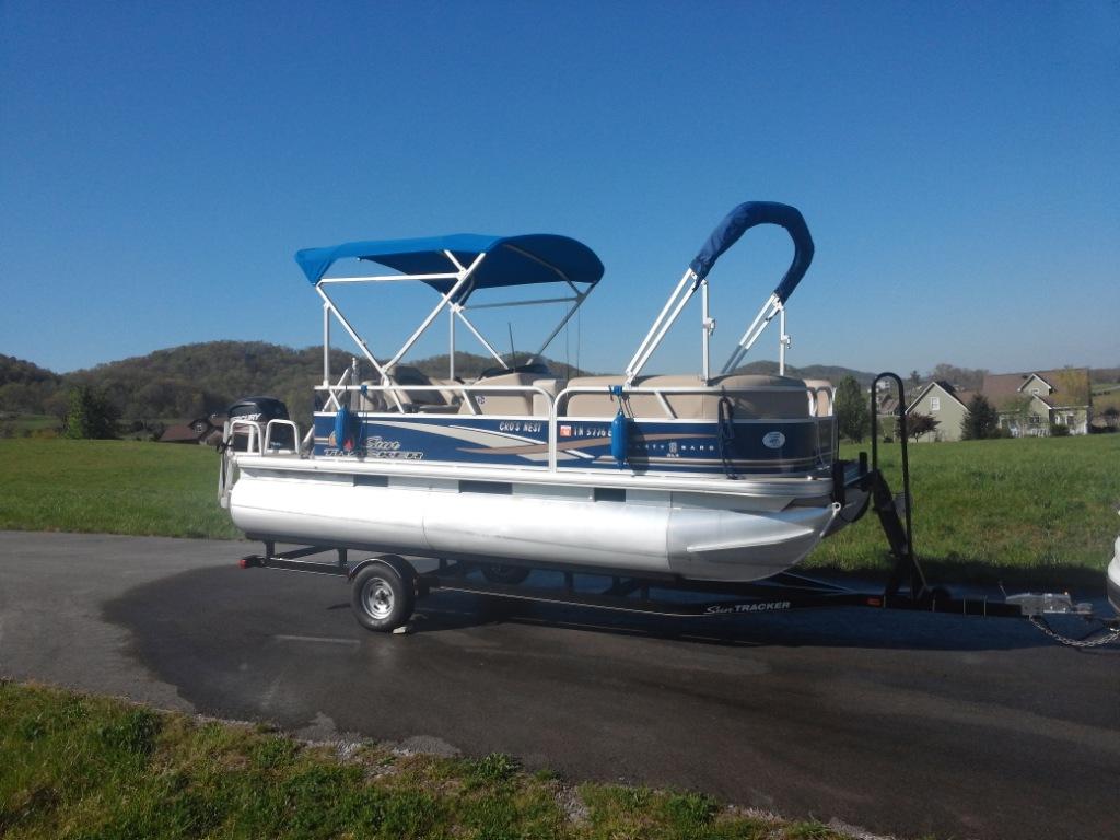

As in tilted forward and completely down? That should be no problem at all as long as it is not bouncing around too much. I moved the 7 foot 3-bow Bimini from the back of my boat and installed it in reverse and installed a 8 foot 4-bow in its place. The only issue I have is simply because my boat is only an 18 footer that when I located the forward Bimini to have a slight overlap with the aft Bimini that when completely folded down for storage it sticks well outside the playpen gates and makes my storage cover fit much tighter. Depending on how laid out I'm sure you can add either a "C" clip, storage strut or as in my crowded case I'll just be adding a rubber bumper to lend a little support when down for storage. Otherwise I keep our's closed in radar position until more shade is needed.jwachevy wrote:Anyone see any issues with running the bimini tilted forward while underway on the water? The only issue I can see is that the rear frame member (the one that normally holds it tilted back) doesn't have a "C" clip to hold it but I see those can be bought and added if I find it bounces around too much.
