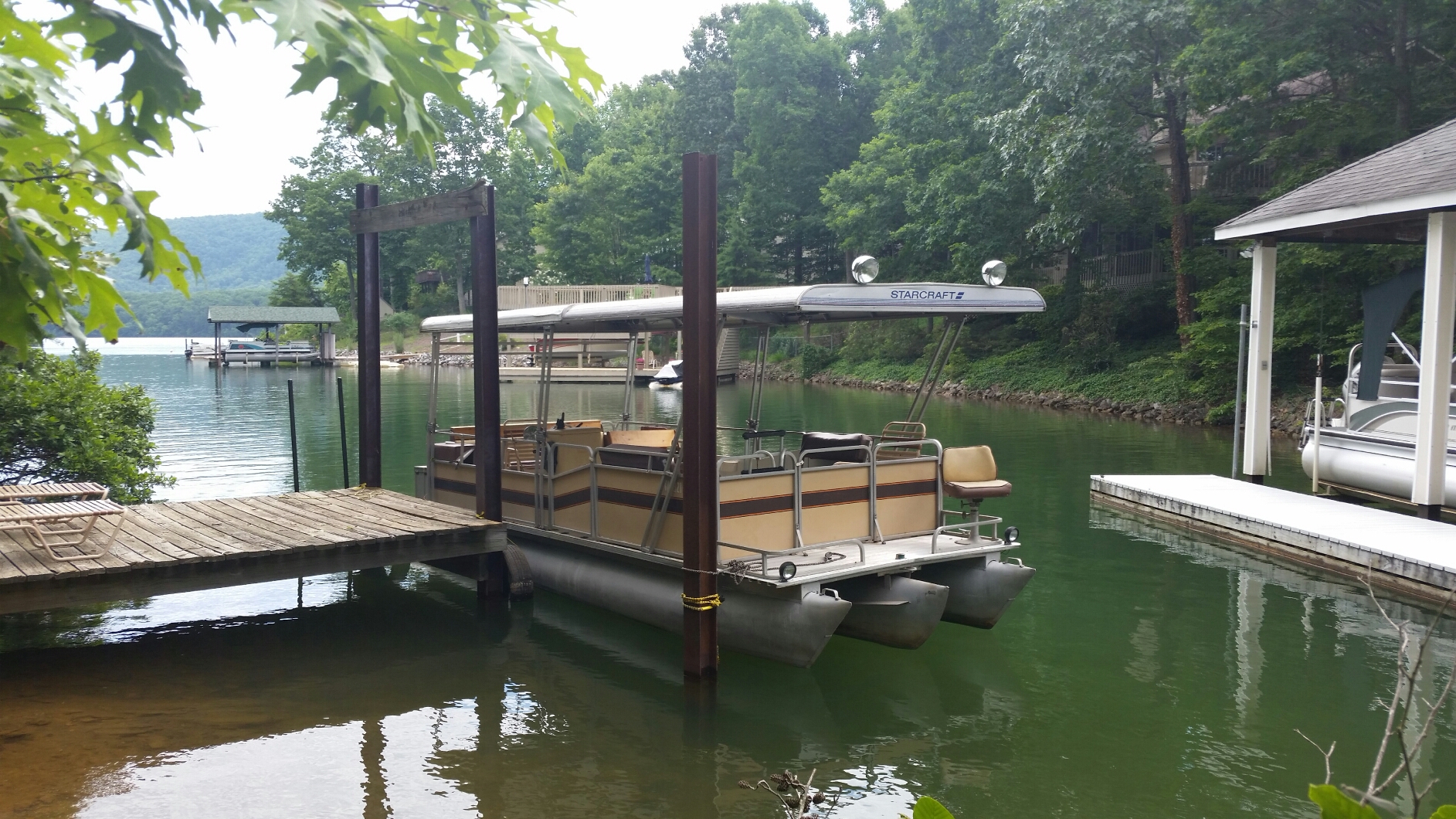

I recently added a Suzuki DT 140 HP outboard to my 24' tritoon. It came with a plastic 4 blade prop that I have no idea what the pitch is and I don't have tachometer yet either. The top speed is currently 24 mph. Just wondering what prop others are running with similar setup so I know where to begin.
