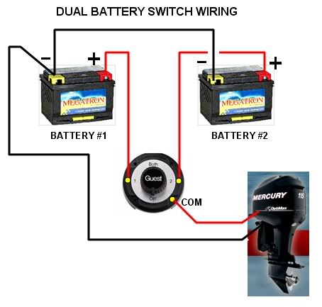

#5 Post by Capt Sully » Tue Jun 14, 2016 6:54 pm
Here ya go.

I always add a second battery and set it up just like the picture that Capt Sully posted.
I alternate which battery I used. One day on battery 1 - driving and parked at the cove. Next day on battery 2 - driving and parked at cove. If I wear down one battery, I have a spare to get me home. Knock on wood, never been stranded in the party cove due to a dead battery!
A second battery give you piece of mind!
