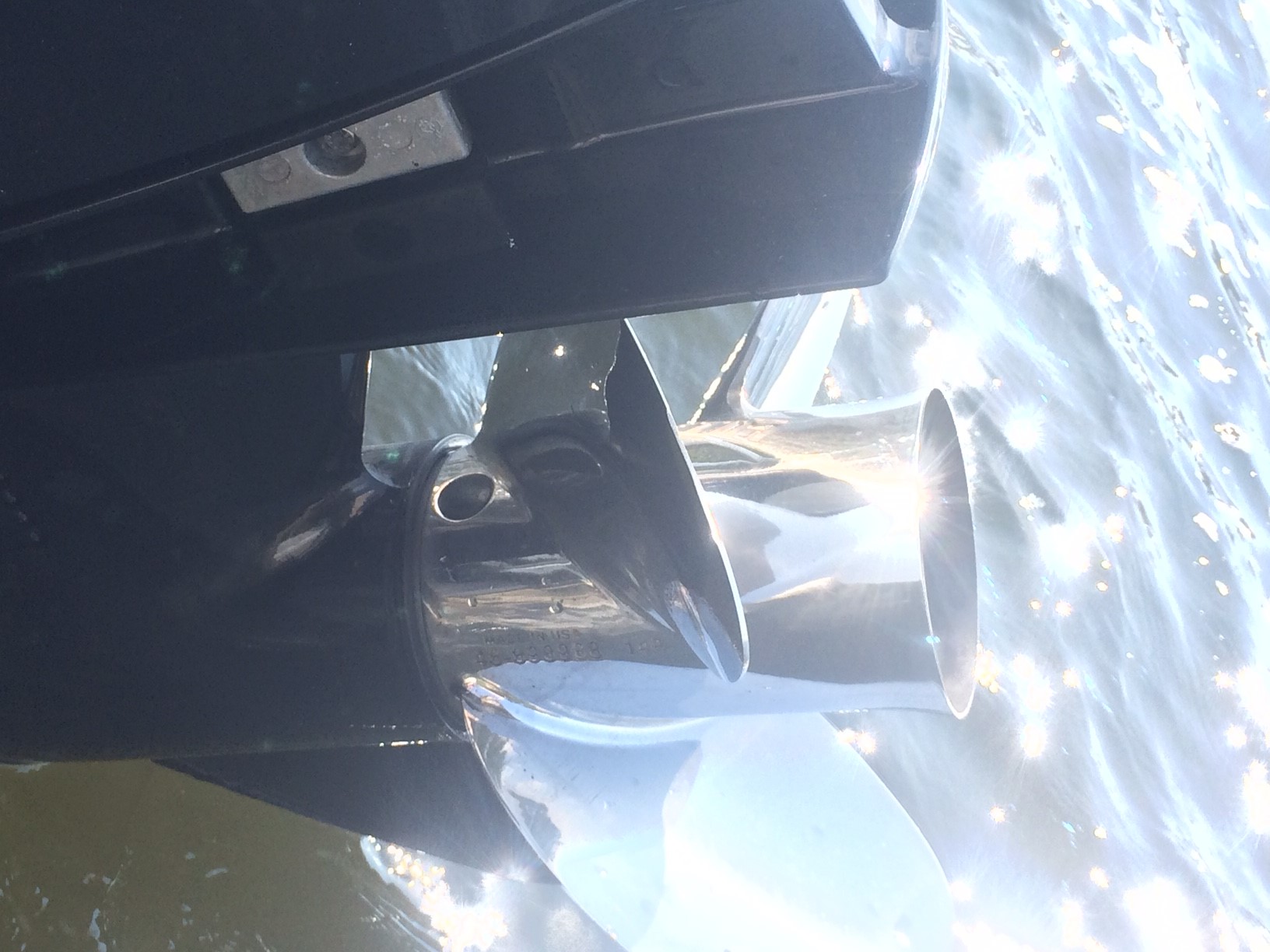

This is my first time posting on this forum. I just got a new 2014 Crest Tritoon with Upper deck. It has the CP3 package with lifting strakes, etc. It is equipped with a 2014 Mercury Verado 200 (4 cylinder). The prop is a 3 blade stainless Enertia with 14pitch. I find that I need to keep the trim about 80-90% of the way down or else it will start slipping. WOT is achieving only about 33 MPH right now and only 3900-4000 RPM. This motor is rated for a much higher RPM (I believe 6400 should be WOT).
What do you recommend? It's a brand new motor and a brand new boat. Using the rule of thumb of 200 RPM for each pitch reduction, I would have to go down to a 2 pitch prop.. which makes no sense. What do you guys think?

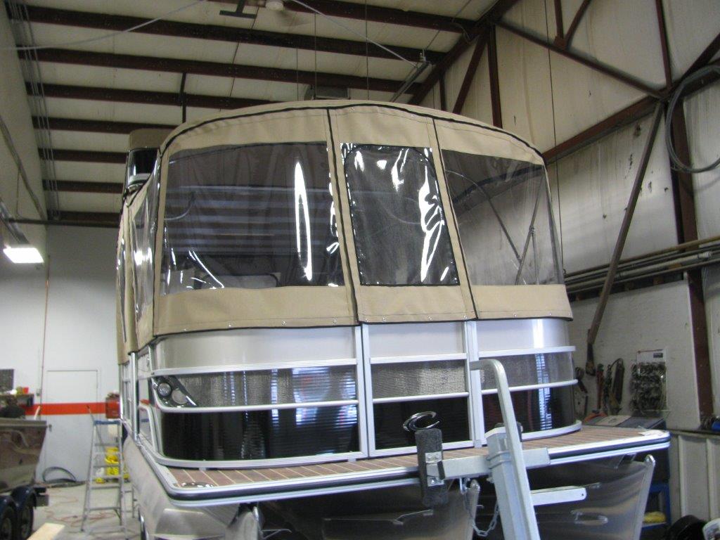

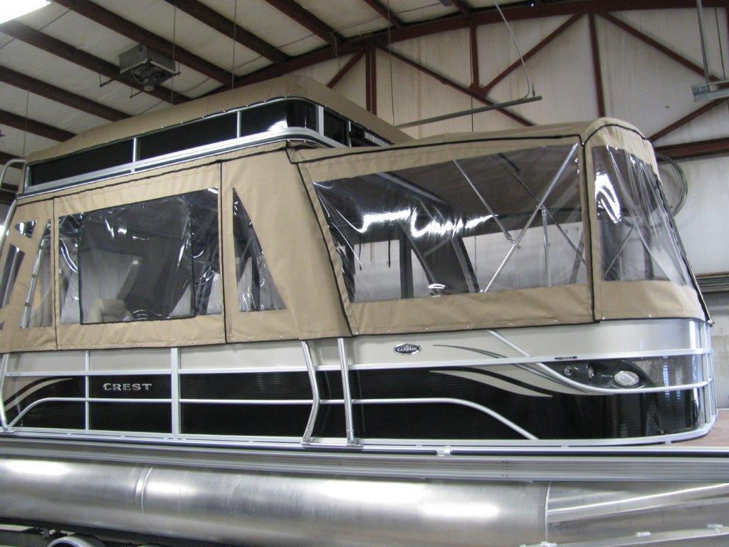

With the full enclosure on, it's got the aerodynamics of a houseboat. And like was said previously, the hardtop also adds weight.
